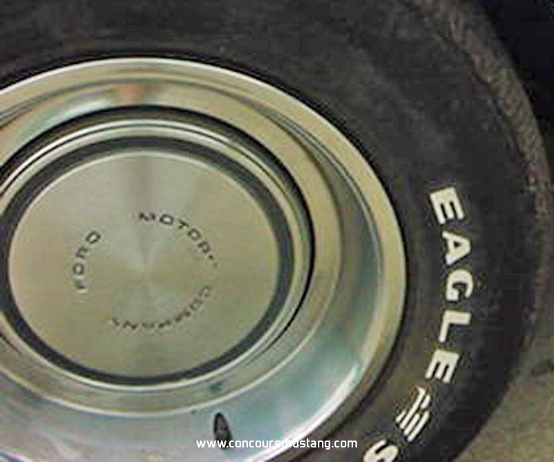

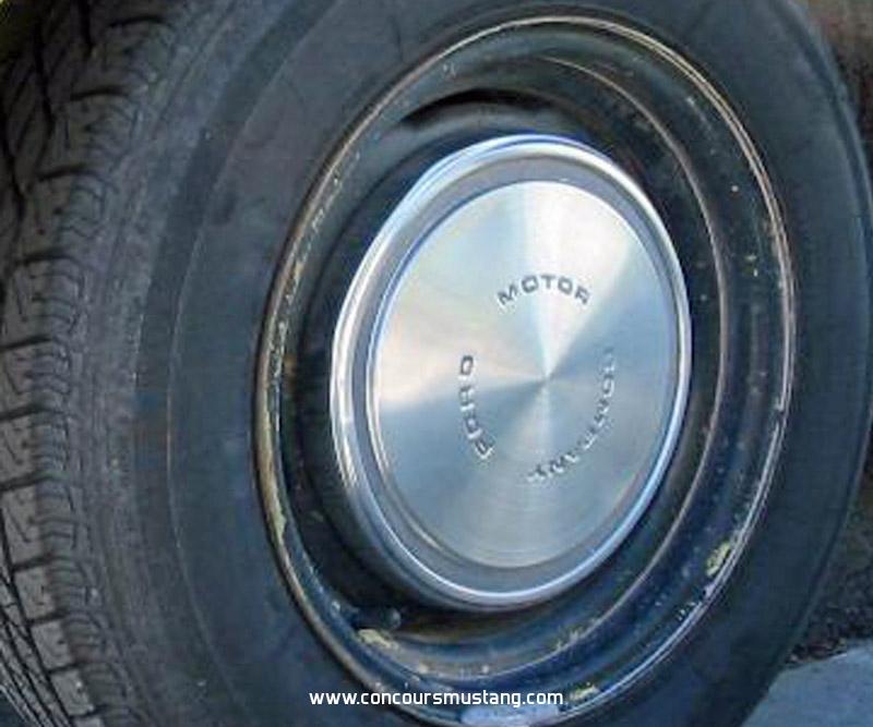

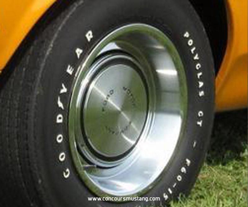

The amount of shine or finish on the pieces is another matter and what we see out there is often the results of seeing originals and NOS (service parts) especially on restore cars -  all in varying condition
I've collected some examples which I will format and post in hopes that this will help you

As promised :)
Just a few
Not sure that I fully trust this one since its on a restored car- could be one or the other are service replacements
