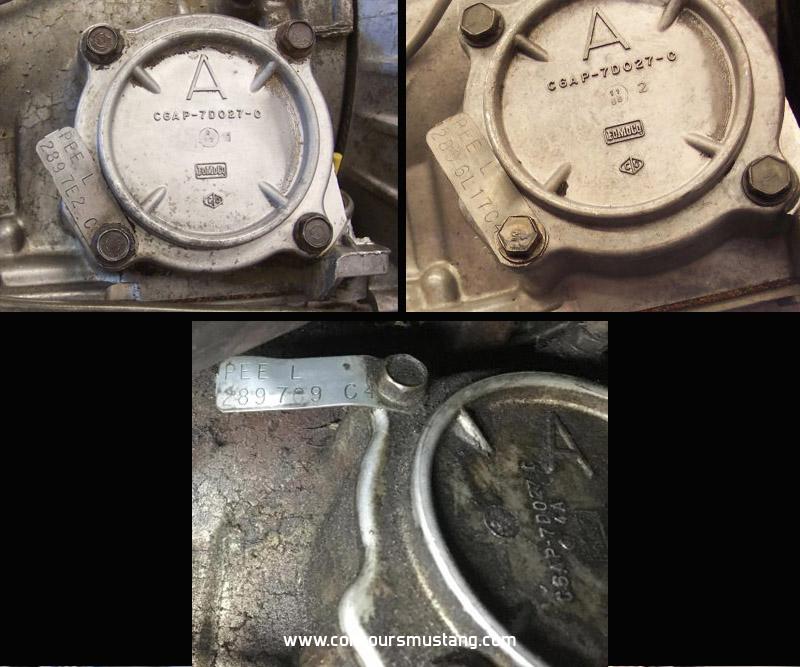

Picture of the servo covers and ID tag. As you can see there were at least two versions of the servo cover used Engineering number either horizontal or vertical. IMHO the horizontal was more often seen/typical on Mustang applications. Must have just been a supplier thing
These appear to be date coded inside the round depression with month and year. From top left to top right then bottom  Feb 67 (E on ID tag) - Nov 66 (L on ID tag)- Feb 67 (C on ID tag) for those following that sort of detail  :)
