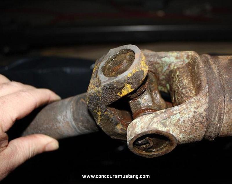

a consensus from multiple original examples of 351 3/4 speed cars is coming back with a yellow slip yoke. The yokes on the shafts remain a mystery.  Black is possible on the rear welded yoke but cant confirm that yet.
Have not seen any drive shaft end yokes that were painted black, then machined and finally welded to the driveshaft tube. Over time have found one examples that was shared showing the front welded yoke and the slip yoke from an unrestored 70 M code 4 speed (reported as a June 15th built car) , shown below. This has been posted once before in another thread. Hope this helps. Its tough to find allot of examples that help to support one another
Check the measurements and style of yoke at the rear of your driveline. If the same as the front I believe it would be a safe bet that originally they were both painted the same color as the front one.

If anyone else finds another original example showing the yellow on the slip and light blue on the welded that would be great.  The one example I have that I think is black is so poor that you really cant see it in a picture.  The drive shaft I am going to use I got from Dead Nuts On as a reproduction but Im using an original slip yoke.  When I have it together I will post a picture
