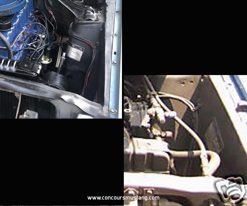

Not exactly sure of what month your looking for information from. If so I could be more specific. Drivers side shock tower as you mention just like typical San Jose practice. On AC cars at least one of the workers would place that sticker on the drivers side forward inner fender panel

A friend of mine picked up a really nice detailed 69 Q-code Vert. Early car. I'm waiting on the build date. Auto AC. Stricker is on the shock tower and the upper cowl has those square stickers along with an F on the ds shock tower above the service decal. Just trying to find out how SJ did them. Car has the pie cut hood. Solid original metal Calif car. Do you have a pic of the screws that hold the lanyards on for hood pins on a 69 at SJ? Thanks. Gary

Not to get too far off thread but since we can keep this short. In general, and looking at the full year of production San Jose didn't use screws during all of production on the GT's and Mach I's as discussed in the thread below. I suggest that if you want to follow this line and discussion repost the request in that thread and I'll try and find some details if your asking about the period when they did use screws. Like other details discussed above allot of cars have been modified and cables reattached using screws since the owner/builder was more familiar with practices of other plants rather than San Jose
