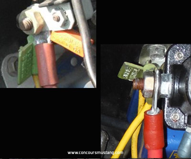

I'm not as familiar with a 1971 harness.  Could the headlight harness of a 1971 fit perfectly in a 1966 with no modifications or changes, along with the integrated fog lights?  Connects up to the under dash harness too?
 This post is almost as much about the missing black /yellow wire from the headlight harness as it is about the fuseable link in the alternator harness.  My alternator harness also has the yellow jumper to the engine harness which is typically part of the headlight harness.  My alternator harness is a little beat up and was looking to replace it.  The headlight harness is in good shape but will not work without this odd alternator harness.  If it did not originally come on this 1966 where did it come from?
1971 is completely incompatible with 1966.  What you have is a reproduction alternator harness with improvements (e.g. fusible link).  The correct 66 alternator harness may be confused with the 65 GT/Pony alternator harness, so be careful.

Fusible links began to show up in 1971 alternator harnesses; for sure by 1973.  The first fusible link in main harness wiring was in 1970.  I've seen some 1969 headlight harnesses with fusible links, but those are not typical (probably service replacements).
Thanks  Forgot about the 71 and up ones. Looked through my pictures and didn't find anything that looked like the OPs had (green rubber label) until I got to the 73's
And yes I've burn up a fusable link (just a section of wire) on a 69 but it was a reproduction wire loom so got lucky and a=only had to replace that section  ::)
