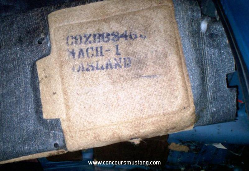

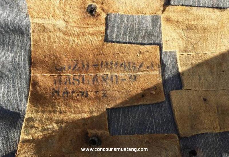

How did you determine the carpet in the picture was an original carpet?
Here are front and rear sections of original carpeting from the back side showing the engineering numbers and other marking from the supplier and how the attached underlayment and reliefs looked
Carpet was often changed early in many cars lives so its not unusual to find really old looking and dirty replacement carpet. Just trying to establish a base to start the discussion off on.
