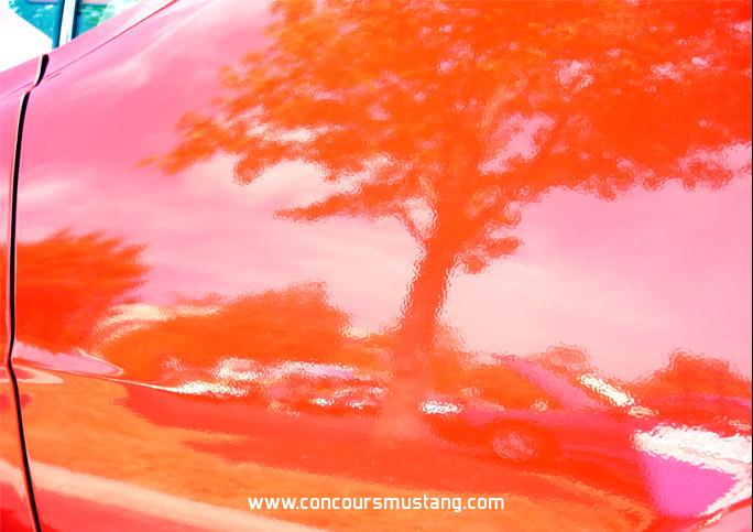

There are panels that naturally allowed for the forming of the orange peel look while others were less likely in production vehicles like we're discussing. Have heard from a fair number that especially on really nice/well restored cars that they are looking for a consistent orange peel in areas where you would expect to see it across the panels. This is different from how some of us judged in the earlier decades when we just wanted to find some evidence - or could be referred to as the "sacrificial" area of the car. When I have the clip board and judging forms I would sometimes use that to highlight the effect by focusing on the straights lines in the reflect of either of those tow surfaces.
Believe this picture or another one from the same car has been shared before
Back to the OPs focus and needs :)
I looked at the 2019 MCA judging rules (the latest version I have) for 64-66 and it says you got to have Orange Peel. The most significant part of the rule says "- orange peel throughout -" which means "a lot" (yes, it is two words). It is subjective.
That looks like more orange peel than I've ever seen on a factory paint job. Just my opinion. I had a 65 mustang since new, and the factory paint was pretty flat, flat as in not much peel, not flat as in no gloss.
IMHO, the best you can get out of the gun without cutting and buffing will leave some peel, and that should be enough.
