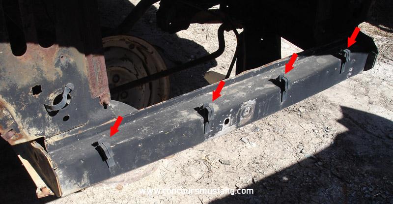

Today I found this clip laying in the front valance. Must be there for a long time.
Have no idea where to go.
Has anyone an idea? May be a pic where to mount?
Seems to be a wire clip.
Pic link.
https://ibb.co/2FMS9CX

At first glance looks like a 377359 clip. Shown on page E7-8115-1 of the electrical assembly manual.

Thx John. Don't have this manual at current.....
But I found it finally due to your hint.  In total there are 4 going along the bottom of the radiator carrying light harness.
+1 wire loom to front cross member retainer
