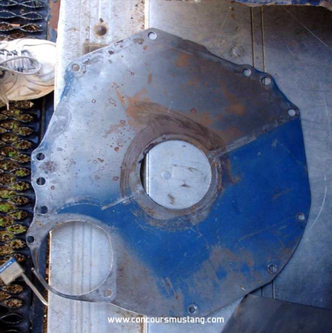

Don't recall ever seeing one with a depressed or formed "smile" like the one you posted.  Looking at other examples of 69 351 Windsor pictures I don't see it on those examples either. In addition the Boss 302 engine plate is like your example on the left. Will up date this post with some pictures in a few minutes. Might want to check the stamping date. Can't recall how late they did it but on earlier ones, unlike almost all sheet metal, they included the year in the stamping. Don't have a later one to look at this moment to check.
Best that I can offer in pictures at the moment. More automatics (Mustang and Shelby 351 Windsors) built and less pictures of the manual transmission plates for at least me
Hope this helps in some way

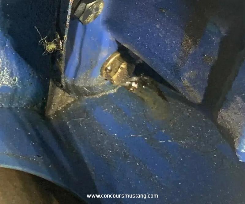

69 Boss 302
69 351 Windsor. Only the area near the starter but if it had the depression as your picture shows I would think we could see it
