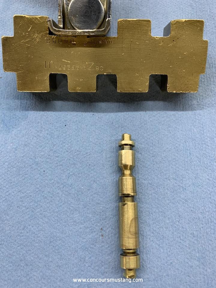

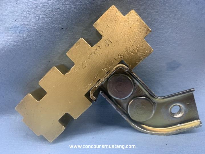

Well good news I got the piston out with heat. Perhaps if I had heated it more yesterday it would have come out. However the bad news is the piston is bent. So I guess I need to get a new/replacement unit. Unless someone has an extra one kicking around they would be willing to part with.
Offline bullitt68
  • Posts: 2221
Well more bad news. Well it turns out that I bent the distribution block when I swaged the bracket back on the valve. Its toast. Need to find a replacement. If anyone has one please let me know.
