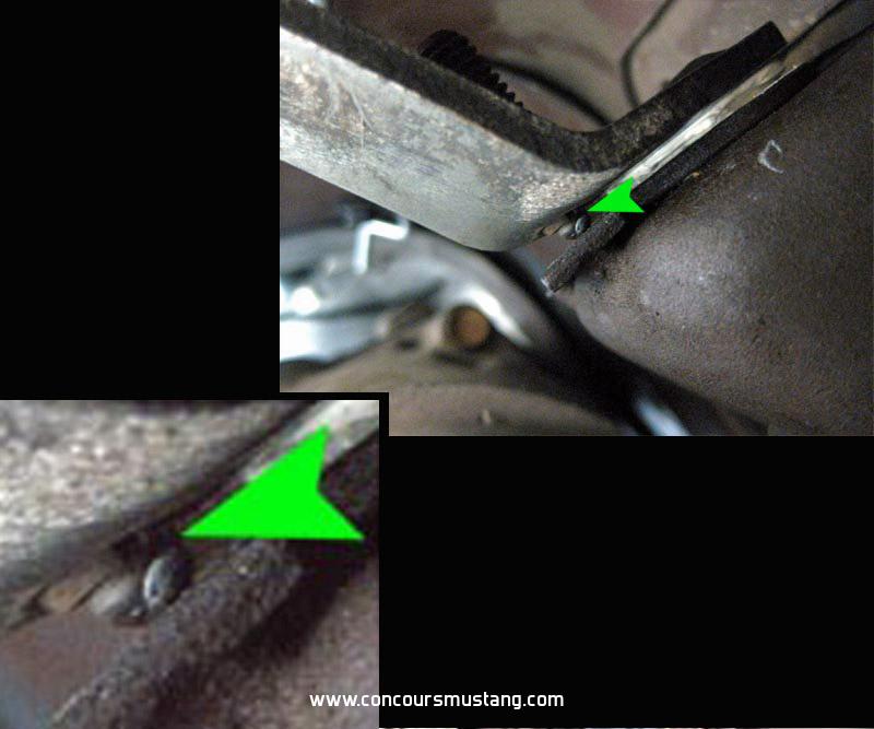

A1- Small lower plated that the indent shaft connects to. The adjustable shaft has a inner moving detent shaft rounded at one end and is spring loaded

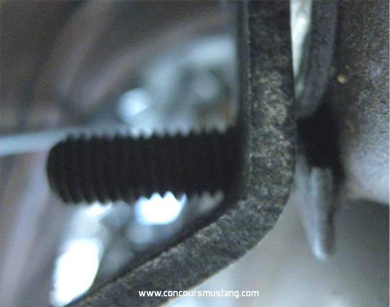

A2- Lower indent shaft

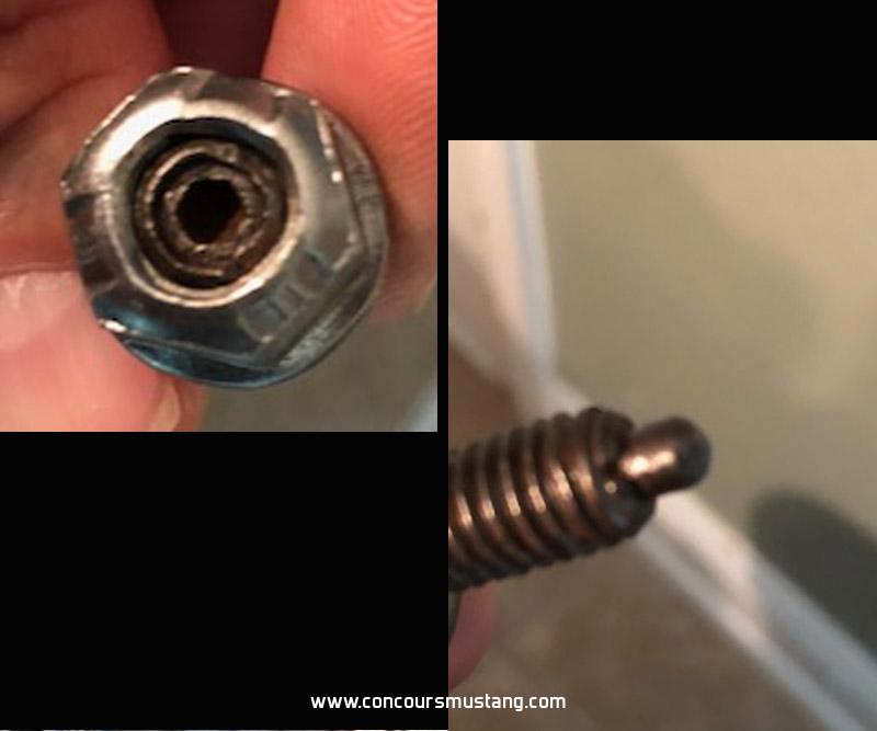

A3- An example of the spring loaded end that road across the plate added to the base of the shifter.Please ignore the shinny nuts they used on the shaft to remove it from the lower shift arm in the upper left of the picture

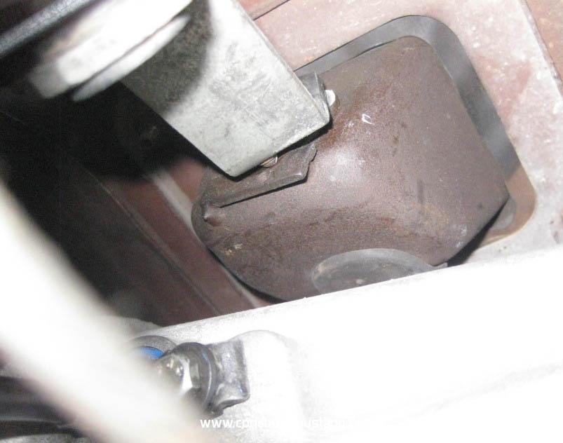

A4- An over all look from below

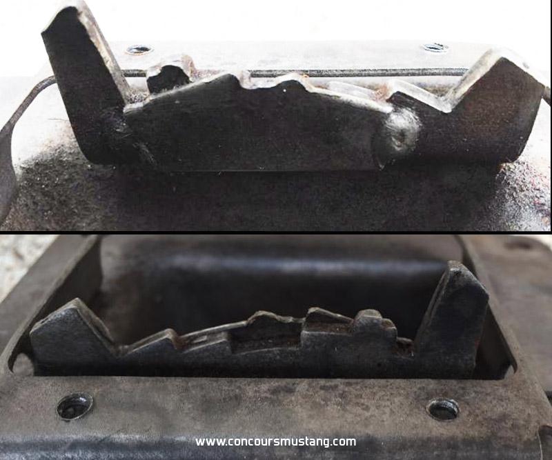

A5-  Upper detent plate added/modified
