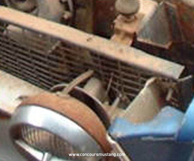

Hi all, does anyone have any images of the way in which the fog lights are attached to the grill, and how they are mounted.  Any images of the rear of the grill etc to show the correct brackets and the correct brackets for the grill iteself.

Correct, the fog lights on the front grille and how they are attached.  The previous owner made up some rough brackets that have now damaged/broken the Grille.  Also should the wires for the fog lights be at the top or bottom of the buckets once they are fitted.  The bottom makes more sense because of water etc but mine are fitted to the top.  Doesnt seem to be a way to turn them over as they are pre housed with no way to swap sides.

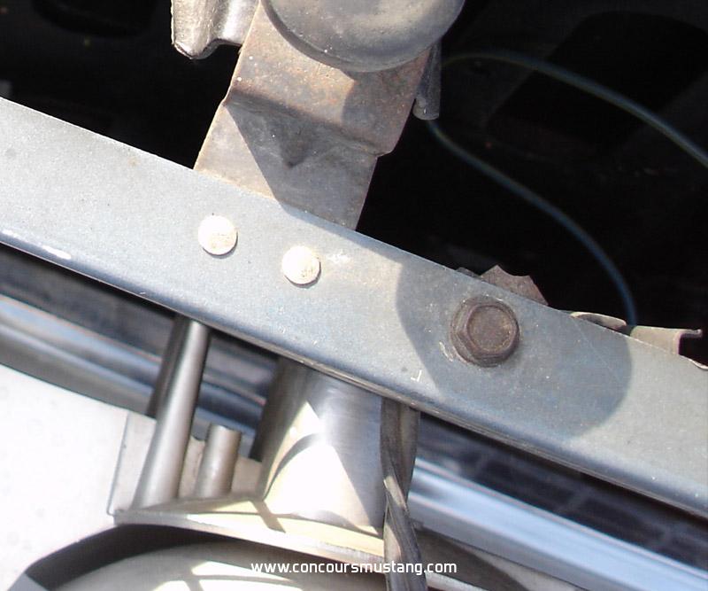

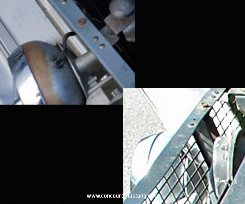

Here are a few pictures with a few details and clues. The bracket is attached to the grill with the hex headed sheet metal screws. If I recall correctly two at the bottom of each and one from above. Wire hole and wire for each light are clocked so they are on top and run over the grill arm attachment points.
Might want to look on Ebay there may be an assembled grill with the horse, corral, arms and parts already installed. Its worth a shot. Don't have a 67 Assembly manual handy to see if other details are covered there for the GT or GTAs
Hope this helps a little
