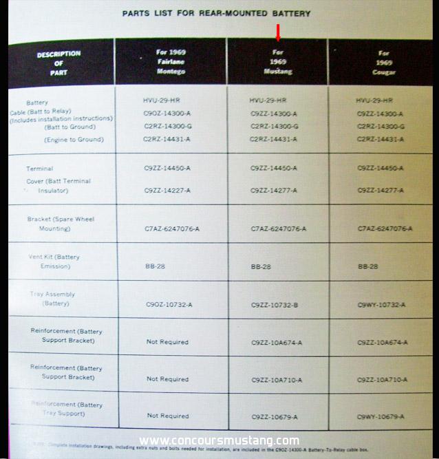

Did find this while looking. Not sure of the source but would guess it was from one of the 69 publications for the Muscle program

Thank you for the information.  As you can see, installation instructions were provided with the parts.  Surely someone in their collection of period Ford literature would have a copy.
