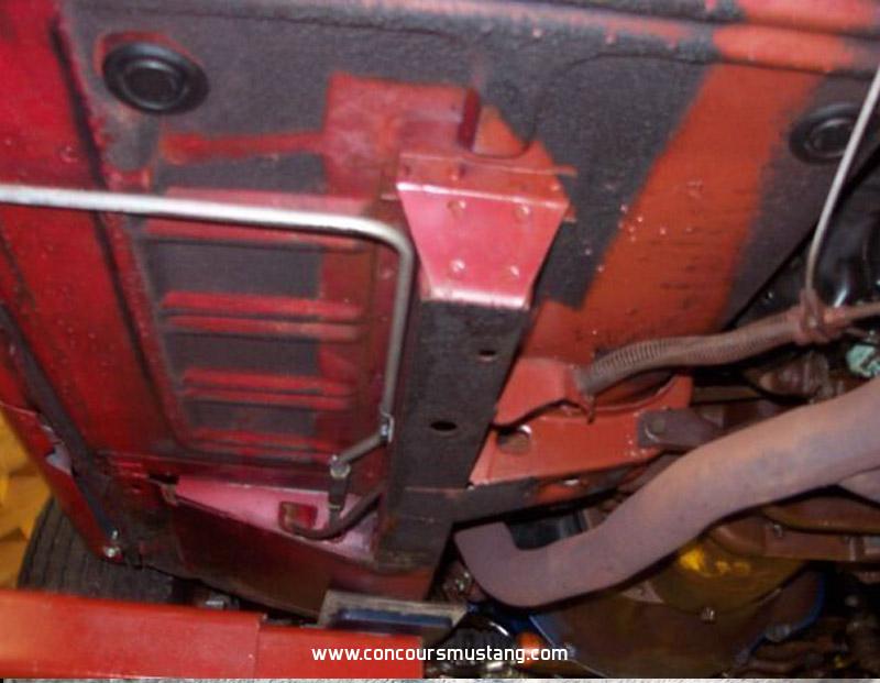

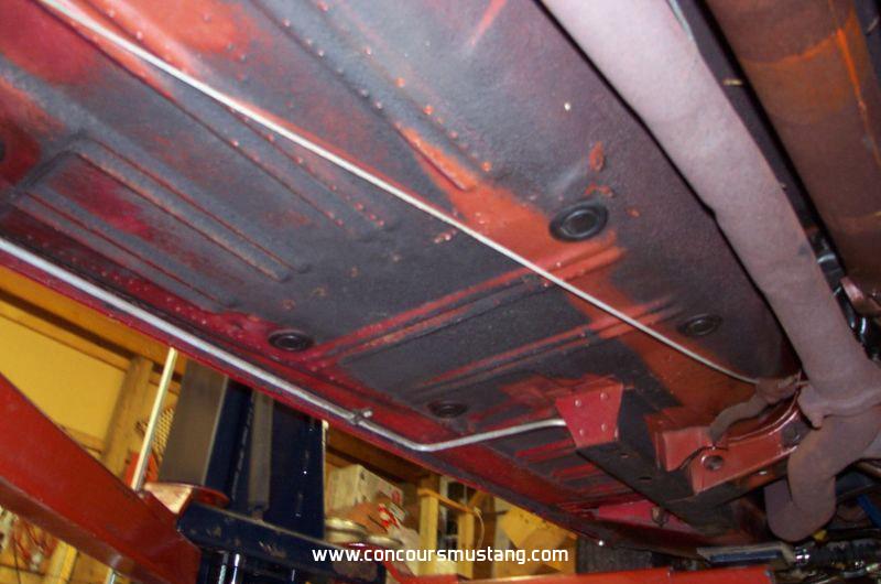

As a follow up and as promised to the OP here are some examples of 69 Dearborn sound additional sound deadener applied to the bottom of the main floor panel. The application appears to vary allot depending on the worker spraying the product. Sometimes they started further forward on the torque boxes while other times rearward. Full heavy coverage to a light covering. Miss a spot, no worries. Miss a side or the tunnel - keep it moving. In general from observations it appears that in general the worker stood towards the center of the car and made three passes. Tunnel and then both sides. This often produced deep shadows behind or to the outer side of the front frame rails. Exhaust appears to not have been installed yet but the seat plugs and e-brake cables were.
The practice of applying this coat of sound deadener was done on Mach I's, Shelby's, Grande's and some/many Boss cars for some unknown reason not connected to the interior type. The latter Boss applications puzzle me currently.
Here are a group of cars I'm using for examples today. The production period spans from late fall/early winter through about July.

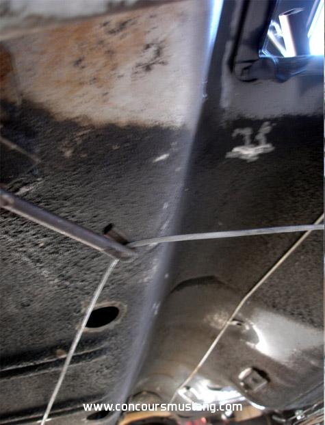

Starting out with a well preserved example though I wasn't able to get a VIN for this one  :( Lots of contrast and hard visible shadows suggesting where the worker was standing and how the applicator was angled.
A-1
A-2
A-3

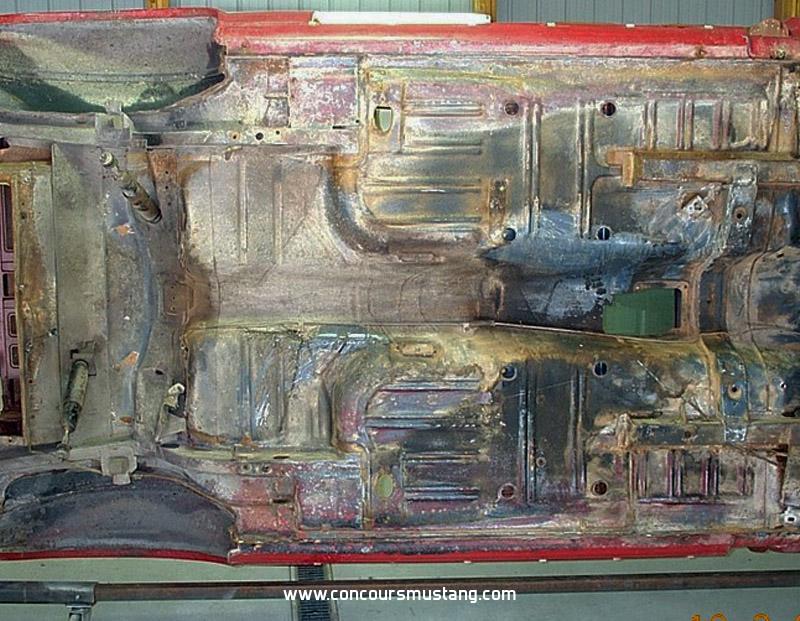

9F143xxx Shows the whole floor section though not as clean or clear ad others. Shows the application all the way to the rear seat riser area of the floor panel

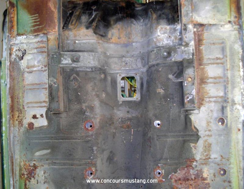

9F188xxx And April built car for your comparison to your April built car. On this car the tunnel pass was skipped and the worker did not extend rearward the side passes of the applicator

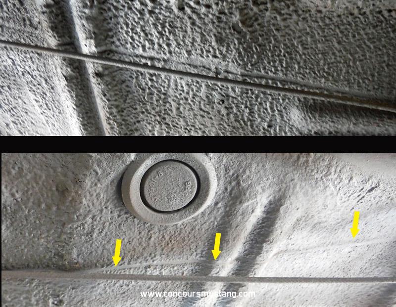

B-1
B-2 This picture shows the shadow of the e brake cable. Also confirms a single pass since multiple ones would have reduced the shadow affect.

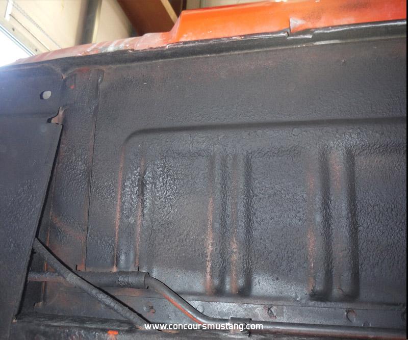

B-3 Difficult to see in this picture the applications start on the torque boxes. For others viewing. This car has been repainted and is the reason we see the orange overspray over things like the sound deadener and the fuel line that were not on the car originally when the body was painted

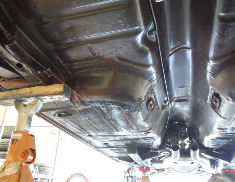

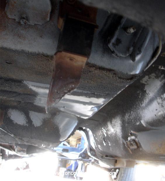

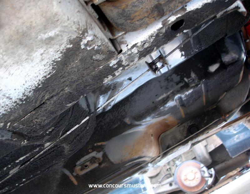

9F2227xx This example if from one of the cars in the unrestored picture section of the site. All indications is that its likely a July built car.
C-1 Very much like the April built car from this angle except this one had the tunnel coated in places as well as some of the rear seat riser area. Nice contrast with the white exterior paint overspray.
C-2
C-3 Forward center section
