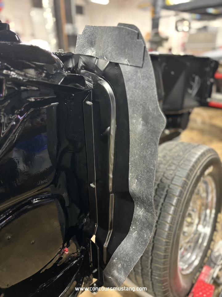

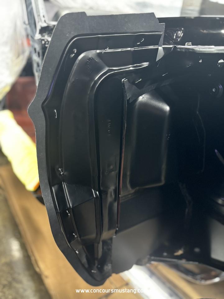

How about the fender brackets on the bottom, in a previous post it was suggested that they were in the wrong position.
L shaped bracket was sandwiched between the unibody and the splash shield so that it is not visible (except for the bend below the splash shield) under the splash shield or retaining screw
Also should the rubber overlap at the top or should it get trimmed to fit.
Over lapped
Over lapped
Great thank Jeff. Looks like my fender bracket is installed correctly.
FYI Roger also just posted a couple of great reference photos of his original paint survivor car. Observed on his car the top shield/flap is on the front side of the metal shield and the long vertical rubber shield is on the back side .
