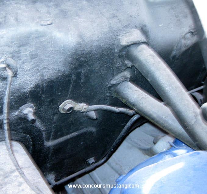

I will get the manual but I am wondering what those holes on the firewall are for?
  • Posts: 9520
Re: Heater Hose clamp or bracket
« Reply #3 on: April 15, 2024, 10:04:41 PM »
One could be for the engine block (back of the head) to firewall ground. Also you have larger holes for the rubber plugs holding the firewall pad on.  That is in the electrical manual . https://www.npdlink.com/product/assembly-manual-1969-complete/217284 . It is all covered in the manuals.

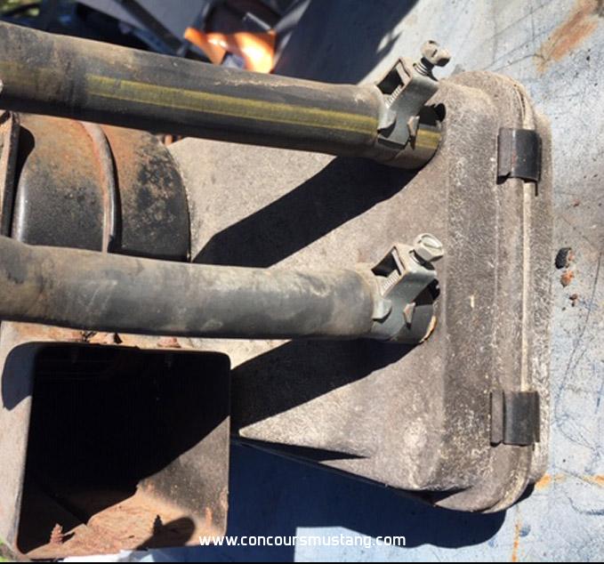

The two hoses pass through the firewall and attach to the non-AC heater box/heater core at the nipples. No bracket to hold them and clamps only in the interior - not visible from engine compartment on a non AC car
Different year but same design and route
The other ends attach to the nipple on top of the intake (front) and the other to the second water pump nipple at the front of the engine
There is a whole handful of pictures of the engine compartments in the Unrestored 69 Mustang section. In some cases (common after all these years) the hoses and clamps have been replaced but will at least, in those examples, show you where they attach. Any of the non AC small blocks should help
