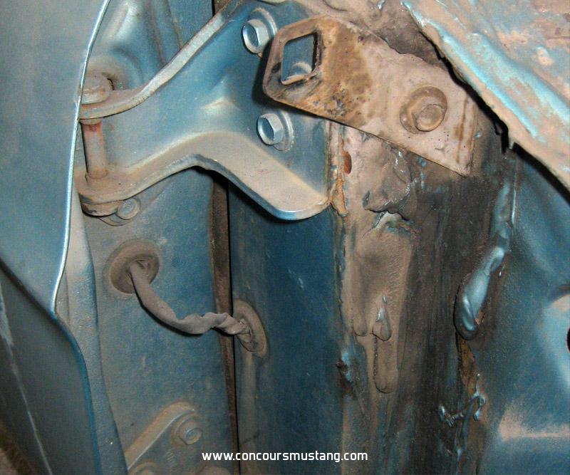

67 Fastback with factory Convenience group. At some point the doors were replaced with non convenience group doors.  No cutout for courtesy light and no pass thru on A pillar for wiring to the door.. The cutout is no problem. What is the location of the pass thru? Was there any shielding or protective cover from the pillar to the door? Any photos would be of great help.

Hope this helps. Happens to be a San Jose built car not sure where your car was built or when. May make a difference

If my memory is correct there are locating dimples in the sheet metal that you can use for reference

Your memory is still going strong; There are locating dimples on the door and on the door pillar.
