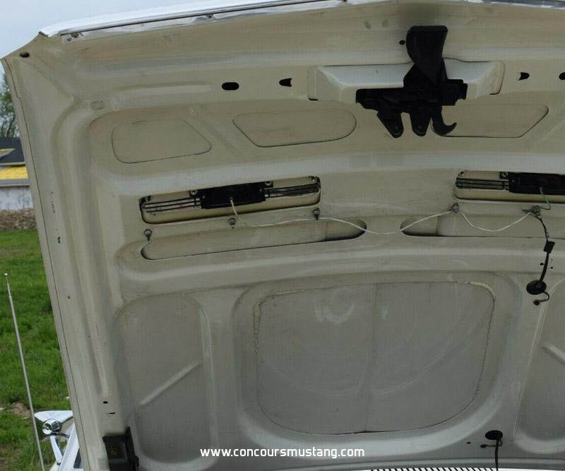

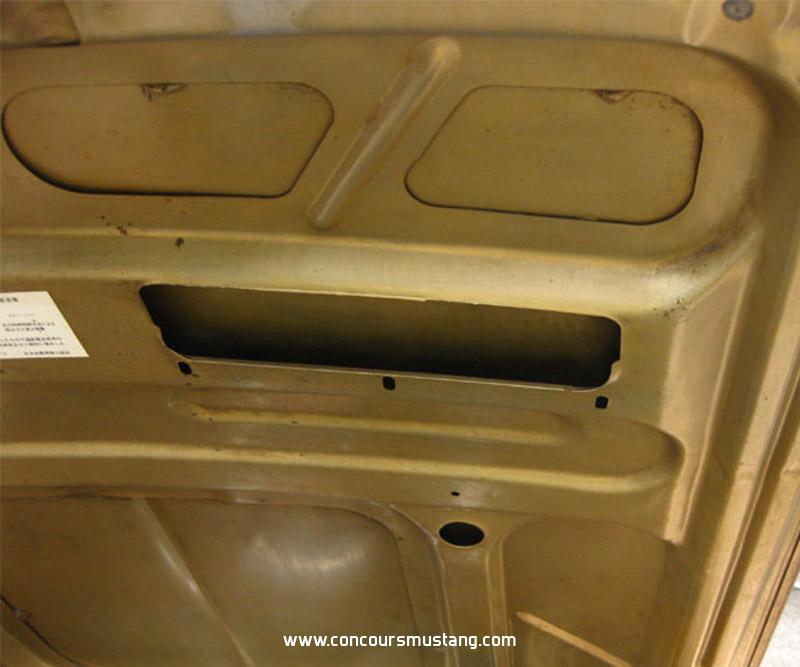

Not sure what your using to identify 67 from 68 hoods. Both "flat" and turn indicator styles appear to have been available through out both years of production.
Here are examples (most from unrestored cars - pretty easy to tell) from the later part of production for 68 at NJ 8T19600-8T212xxx
But will start with the flat version of the 67 - late NJ example  7T2225xx
Late 67 production turn indicator style 7T227

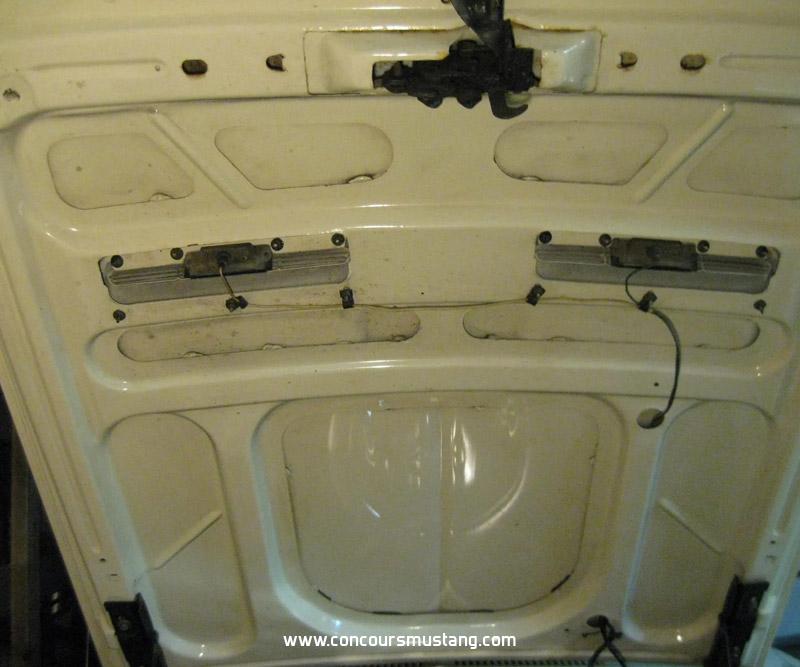

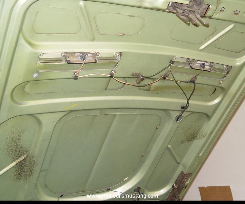

And the 68's
8T196xxx
8T199xxx
8T206xxx
8T2098

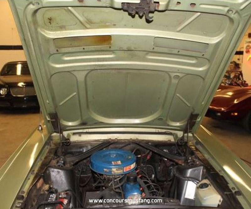

8T212xxx Hard to see but flat hood with the inner liner/structure shared with the turn light hood

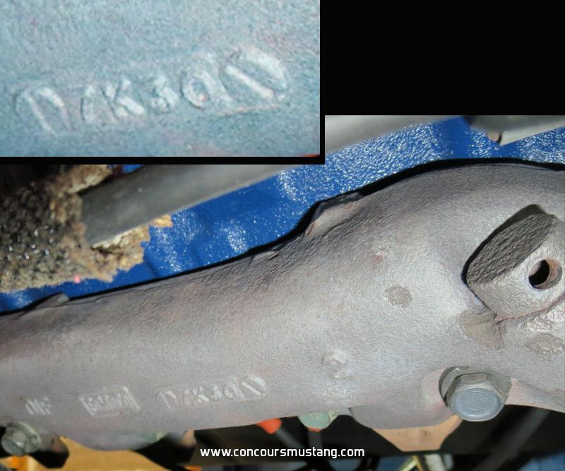

Looked through my files and pictures hoping to discover what, if any, parts were being made during the strike at the car plants. First looked at sheet metal but soon remembered that since those stampings do not include the year moved on to other parts.
Found a passenger side exhaust manifold that was cast after the strike started so it looks like not everyone was on strike and Ford was still making parts for cars in preparation for the restart.  At least that is the conclusion I due from this finding
Strike started (based on Pete's info) Sep 7 67/7J67 to Nov 11 67/11L27
Exhaust manual below used on an engine that ended up in a 8T02S1295xx a 68 Shelby. Casting date Aug 30 67/7K30 Which indicates that it was cast over a month into the strike at the car plants.
Car did, when inspected, have a couple of panels that were stamped also during the strike period, one being a section of the front frame rail, dated Nov 6th but as mentioned we can't be certain if that was stamped for a 68 or a 67 car and the car did have some panel replacement so not leaning on that finding very hard though with the exhaust manifold date it does raise some interest
