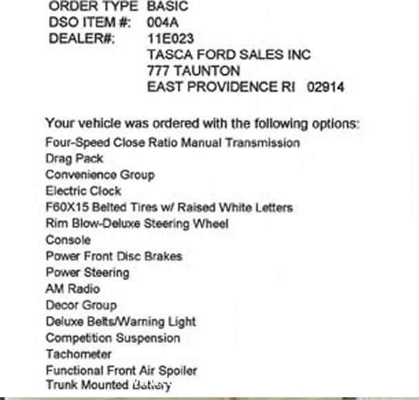

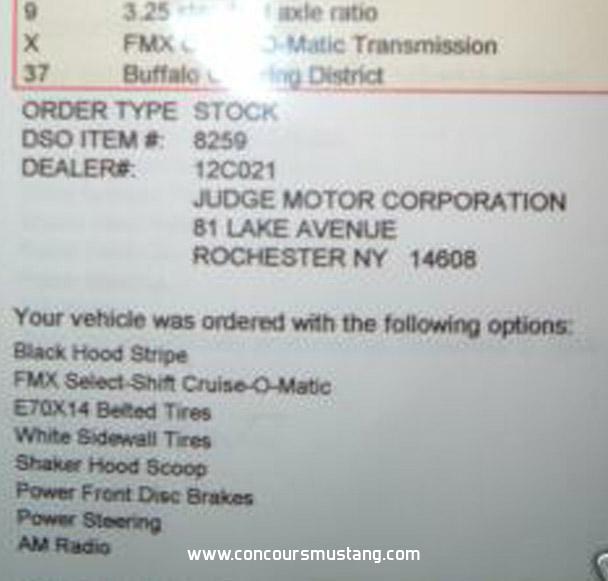

First question is how did you determine that your car was ordered with the "deluxe, bright seat belt" latch covers? Guess it was a Marti report so I'm just checking
For others reading this thread here are two examples
Here is a 1970 NJ built white interior (3W) Mach's Marti report not not showing the deluxe/bright seat belt latch covers. This car originally had black belts and black latch covers as well as boots on the outside belts in the front
Here is a 1970 Dearborn built non-Mach with the deluxe white interior and the Deluxe Belts/Warning Light

Thanks for the reply.  I'm working off the Marti report for the car that lists the Deluxe belts with warning light, but will probably invest in the repro window sticker.  Will also try to fill in the details of the car in my profile.
