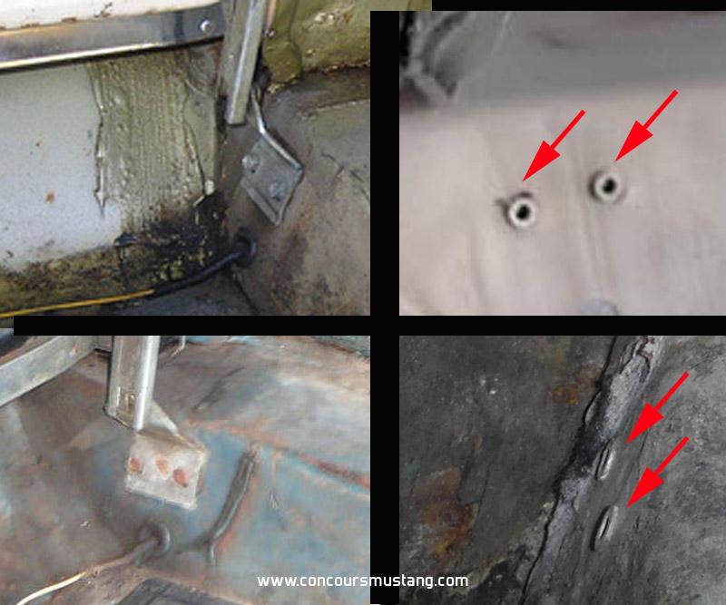

Looking for replacement info for 65 F/B rear seat fold down trap door pressed in nuts for the latch assy where it bolts to the R rear trunk floor

Took me a moment and a couple of reading the request. He's looking, I believe, for the two insert nuts that install over the fuel sender wire pass though hole on the passenger side of the trunk were the trap door arm attaches. From the undercarriage side they have a tall hex nut head. Couldn't locate  picture from that angle quickly so posting ones from the trunk side for now. This has nothing to do with the latch if I read the post correctly. Will correct thread title if that's right

Sorry for the confusion, yes Jeffs picture of the two threaded nuts just above the fuel sender wire gromet hole is what i am refering to thank you.

I believe the nut is Ford hardware part number 376903-S40, a 1/4-20 thread hex body (for retention).
A follow on -
The "original" nut did have a hex body retention method. The replacement nut keeps the same Ford hardware part number and Ford Service Locator Code of "MM-120-BF", but is shown in the 1969 Ford Standard and Utility Parts Catalog (a Jim Osborn publication, AM0205) as having a round body, as if it uses a crimp type retaining method, like a pop rivet does. Several years back, I bought a "pop-rivet" type tool that is capable of crimping in "nuts". (I don't remember where I bought it.). If you are not in the thoroughbred class, this tool and 1/4-20 nut "may" work, depending on the original size of the hole.

Thanks guys those look like the ones ,as far as installing them just a guess  i think when the bolt is installed it crimps it tight to the trunk panel .when i worked at the ford dealership we used a crimp tool to install a similar type nuts on blind panels Chuck.

What I neglected to include (I'm in the beginning stages of a bathroom remodel and sort of busy) was the use of a regular screw of the correct size "may" strip the threads of the screw and not fully crimp the (pop-rivet type) nut.
So, you need the correct tool.
