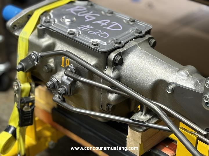

« Reply #6 on: October 12, 2024, 01:50:14 AM »
This is how I finished my shifter rods.
