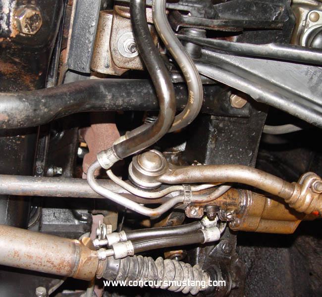

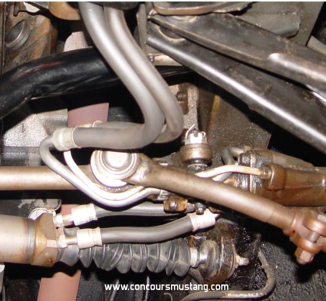

Does anyone have a good pic of the power steering hoses as they look once installed on the control valve with the inner driver side tie rod installed?  I'd like to see the routing of them on an actual car.  I've looked at the diagrams in the assembly manual and restoration guide but would like to see it first hand.  Also is there suppose to be a strap that holds the lines to the control valve?  NPD has one for 67-70 and is part number 3A672 but the 65 assembly manual calls out part number 3C750...

Here are some pics from my wife's '65 Comet w/ 6cyl.  I completed this project last summer transforming it from manual steering to power steering.  Although its Mustang's cousin assembly is very similar.  No strap for the short pressure hoses just the metal bracket w/ rubber insulator that mounts to the lower A arm bolt to secure the long pressure and return hoses.

These are the best photos I have of an original, untouched Dearborn '65 Mustang. No strap that I can see but I do have a vague recollection of a strap or a partial one, which is why it is not in the photo...not sure though.

Here's a set from a Mustang which hasn't been on the road since 1988 - although anything can happen in 13 years.

« Reply #4 on: January 15, 2017, 05:16:57 PM »
Hope this helps - from 5F07A2706xx (one of Mike M great cars)  but the details should be the same though we should IMHO double check the style of clamp since I'm unsure if the assembly arrived at the plant as a sub assembly or was put together at a sub assembly station at each plant
But its a start

Thanks everyone.  I assume that the bends on that end are the same on both a Ford pressure hose and the Eaton pressure hose?  I am changing mine out from the Ford pump to the Eaton pump...I believe Mike has the Eaton pump on the ivy green coupe and a Ford pump on the honey gold convertible.  So based on the VIN I assume this is the ivy green one pictured.  I don't remember what he has on the honey gold coupe if that one even has power steering or not...
But its a start
Jeff's photo is the only one that shows the assemblyline type crimp clamp that holds the metal lines to the control valve.  They are easier to install on the bench rather then on the car if you have a choice. They were probably installed as a complete assembly prior to being installed on the car IMO.
The picture is from the ivy green coupe. Mikes aqua (sorry forget the real color) coupe didn't have PS though as you wrote the convertible does. It also has the/a clamp
+1  Also believe that the clamp was placed on the assembly before it reached the car assembly line and the car. Only concern was did it arrive at the car assembly plant preassembled.  Just clarifying
