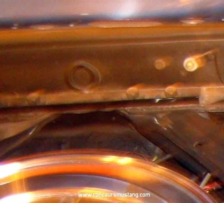

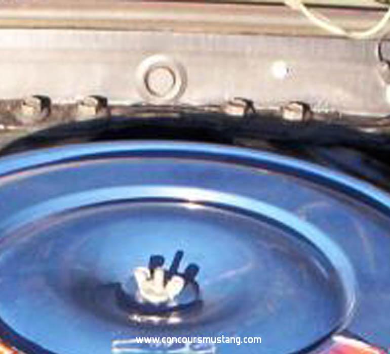

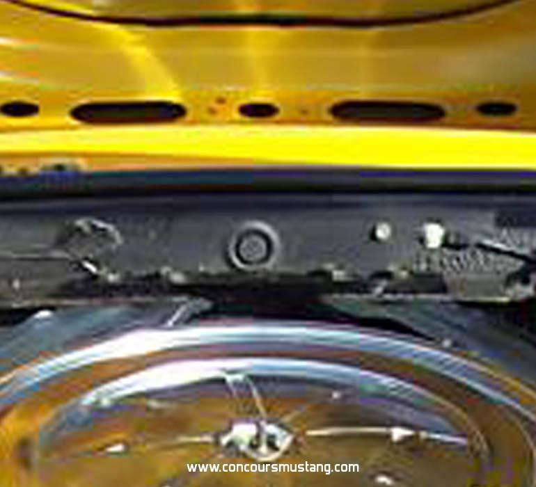

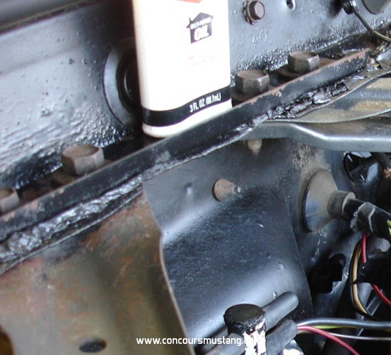

Yep - why we all warn not to just copy blindly restored cars. Yes it easier to assume that someone else did their homework when really its just often the crowd following each other in a circle.  :o But even though I keep few pictures of restored cars I did find allot of the ones I have pictures of did use the P& O finish
So some more original car examples from 70 Dearborn
0F05H1118xx
0F02G1516xx
0F02G1907xx
0F02G1948
