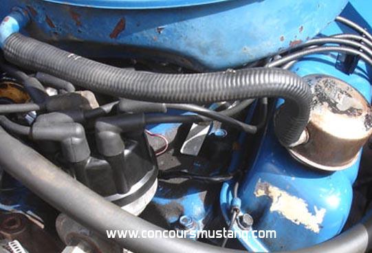

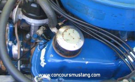

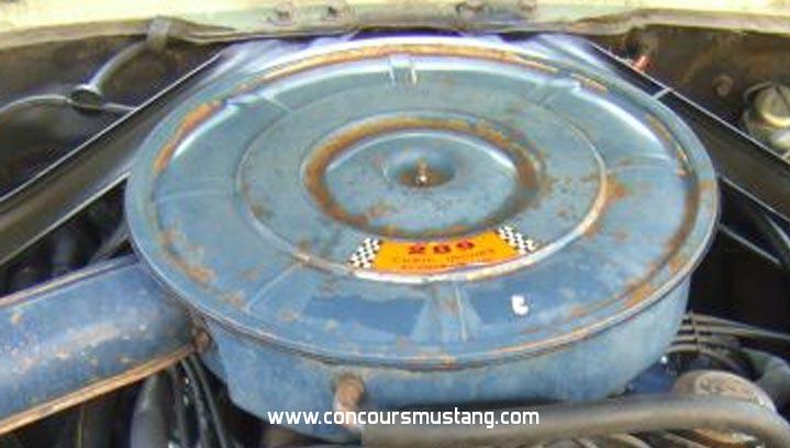

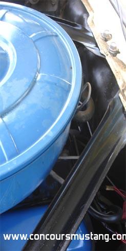

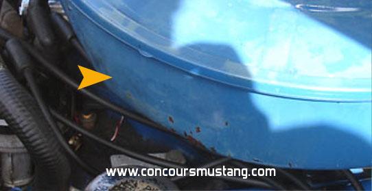

Well since you didn't provide the size of engine,  AC? or when the car was built I'll guess non- AC, 289 and sometime in the spring
Here are a few pictures
What I'm seeing - air cleaner decal, service decal, engine ID, filter service (side of air cleaner), battery inspection,  and none on the breather
Hope these help
Battery check sticker location
