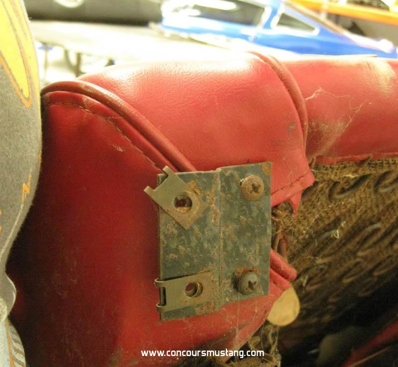

I am trying to install the seat brackets for the lower trim on my 67 Mustang w/Deluxe seats.  Could anyone provide me a picture or two of the lower cushion with the brackets installed, but not the lower side trim.
The seats I have are from a standard interior and there are no holes to mount the brackets and I am having trouble picturing the orientation of them.  Mike

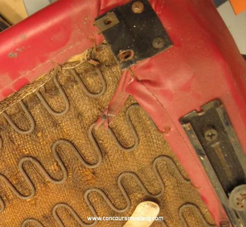

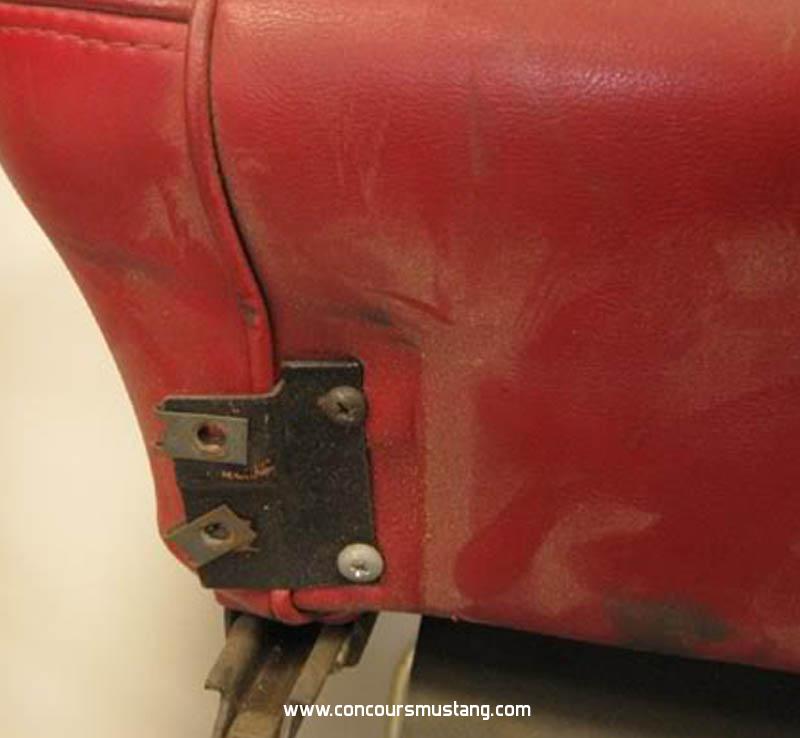

Got lucky I guess - just took these last week. This is the earlier version (smooth inserts) so not sure if the brackets are the same or different but also double check the direction as it appears that the left and right seat in this example have the lower rear brackets installed in opposite directions.
Clip missing ;)

Thanks Jeff, you have come through again.  I guess I am lucky that you just received these.  Not only do I find it interesting in the difference in the orientation of the rear bracket, but how it is mounted.  The lower trim wraps around the rear and I can't picture how it would work mounted on the bottom of the frame.

Jeff your pics did the trick, once I had the seats in hand it all came together perfectly.  I never would of figured that rear bracket in that position.  Thanks for the help.
