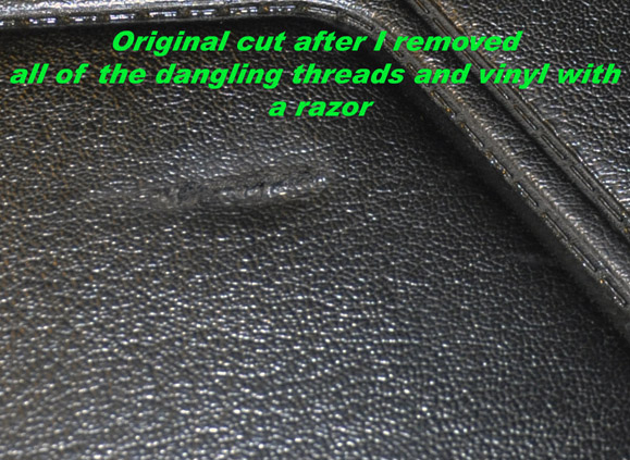

My 70 standard black door panels are in excellent condition for the exception of a 1.5" x 1/4" scrape on the vinyl. The scrape does not go through, but has frayed the surface and is an eye sore since it is not far below the window.

Original damaged area with the cut into the fabric backing an some of the vinyl scuffed out showing the fabric backing. This pic was taken after I cleaned up all of the dangling threads and fibers with a razor so it is already cleaner looking.

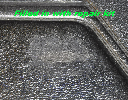

Area filled in with Eastwood Vinyl repair kit. I used the closest grain textured sheet I had and it is very close

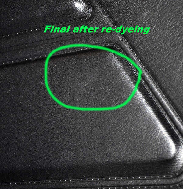

After a light coat of black vinyl dye, and then a few sprays of Dark Charcoal metallic Dye the repaired door panel looks very good. The flash from the camera actually makes the repair stand out much more than when you are just looking at it which is hardly noticeable unless you look for it.
