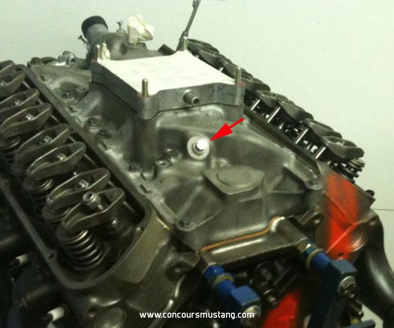

Thank you Jim. I will do that as soon as I get the car home. The DSO is 72, San Jose. Should the intake manifold have the hole in the rear of the intake for the hose?

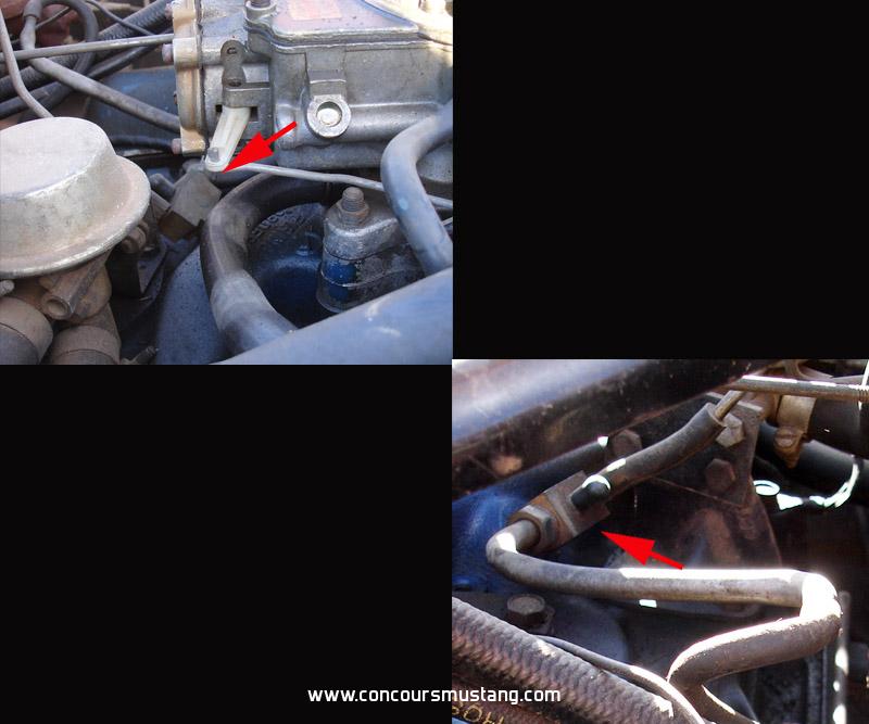

Yes there would be a thread port at the rear of the intake for power brake or vacuum fitting attachment if needed
Not certain if this is a 65 or 66 intake but its a fairly clear shot
On a 66 with the C6 intake - 6R1590xx  Sorry plenty of options and things going on in the space
