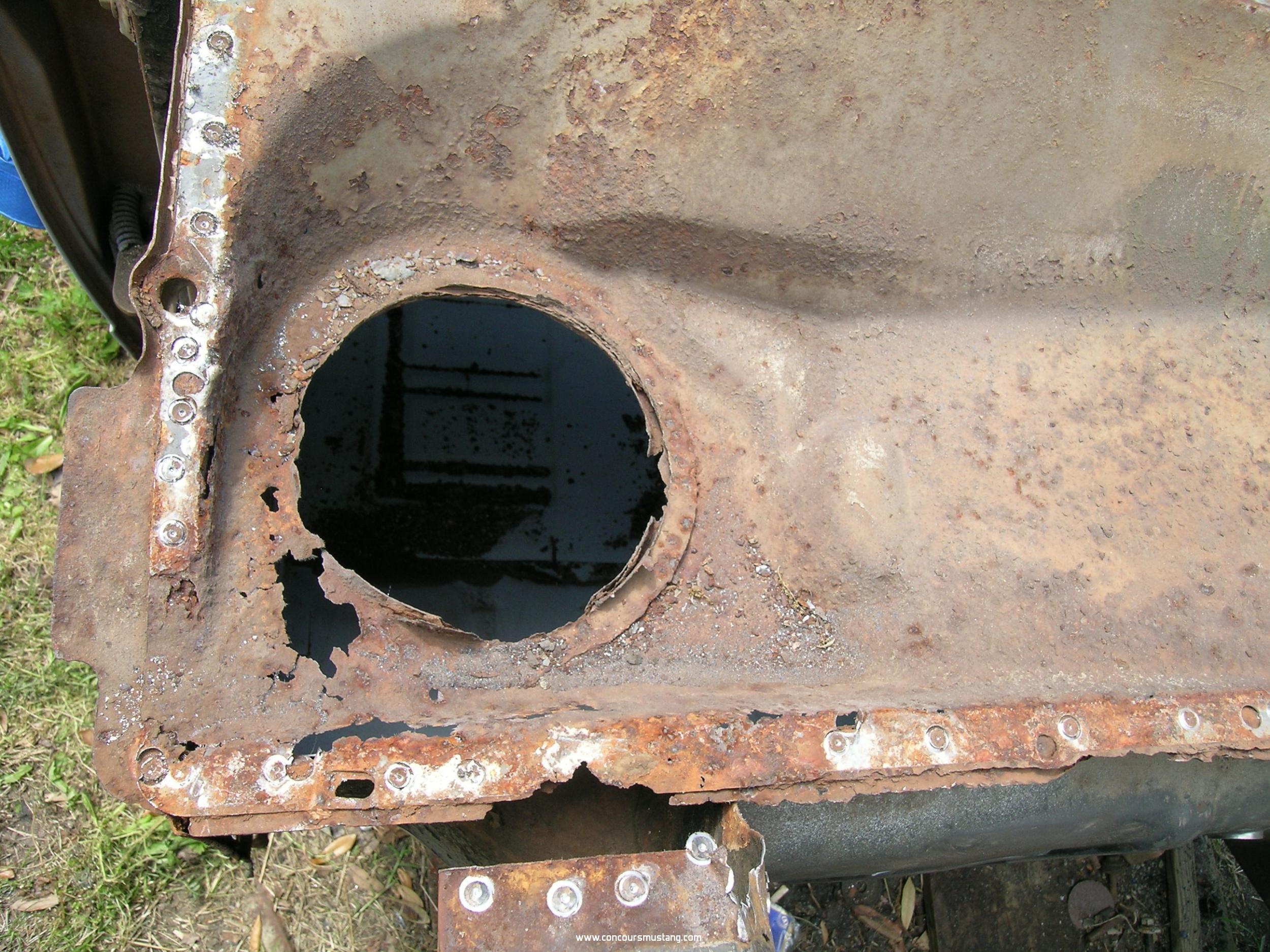

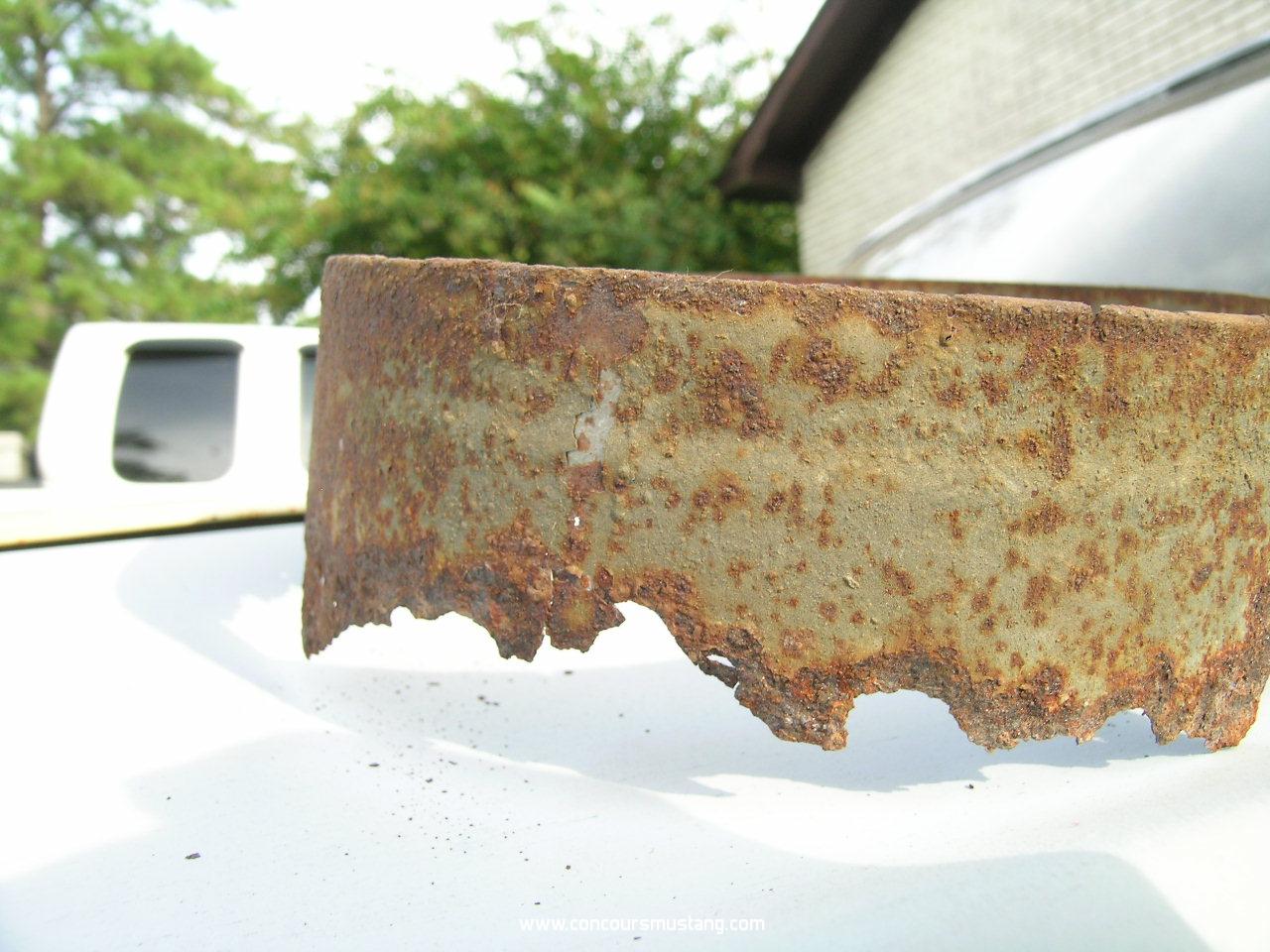

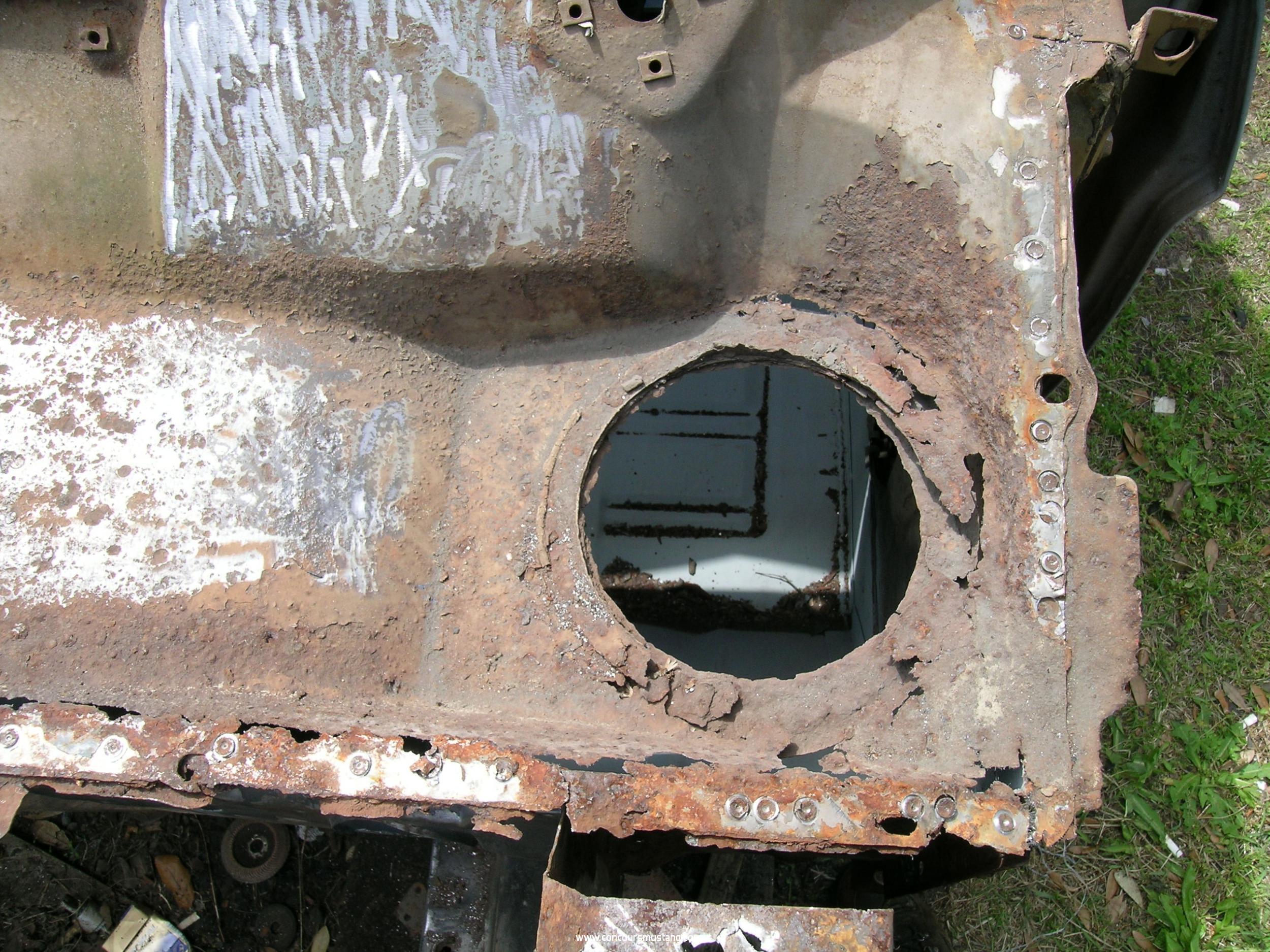

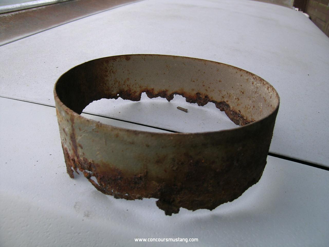

Offline JKWilson
  • Posts: 307
Re: My body primer?
« Reply #5 on: May 29, 2013, 11:39:30 PM »
I haven't really stripped any of my Metuchen fastback down yet. I know it may be apples and oranges, but I have stripped down my Dearborn coupe. It has a black floor pan. I have found red oxide primer in the interior and grey primer surfacer on the exterior. Curiously, when I replaced the cowl assembly I found grey primer inside the cowl. No, it was not overspray. I found the "hat" sections with grey primer and it was a solid layer all the way around. IIRC it's generally accepted the cowl area was not primered, and any coating was the result of overspray.

Offline JKWilson
  • Posts: 307
Re: My body primer?
« Reply #7 on: May 30, 2013, 03:17:45 AM »
Would say this would be the first I have heard about any bottom side fo the cowl being painted well. When you say "hat sections" are you reportign that only the round panels that made up the vent were primered and not the surrounding surfaces? As well as no signs of repair, painting by a PO or such?
Sorry - hope this will not take us away from the thread - if so we can split and continue if we want
Agree with a new thread if it becomes side tracked. IMHO Bryan kind of asked a general primer question, so we haven't really strayed far!
I am talking about the circular portions as well as the lower section of the cowl. I took pics of the lower cowl after I removed the top and the "hat" sections, primarily because I didn't think anyone would ever believe me! ;D  There were no signs of repaint or repairs on the car. Add to that the cowl top would have had to be removed in order to prime the areas I found primer in. Also, due to the high level of coverage, it would rule out just overspray. Here's the pics I shot:
You can clearly see where the primer was starting peel up on the lower cowl. The original exterior color is Antique Bronze.
p.s. You can probably guess from the pictures WHY I had the cowl top off!! ;D
« Last Edit: May 31, 2013, 01:21:09 AM by JKWilson »
