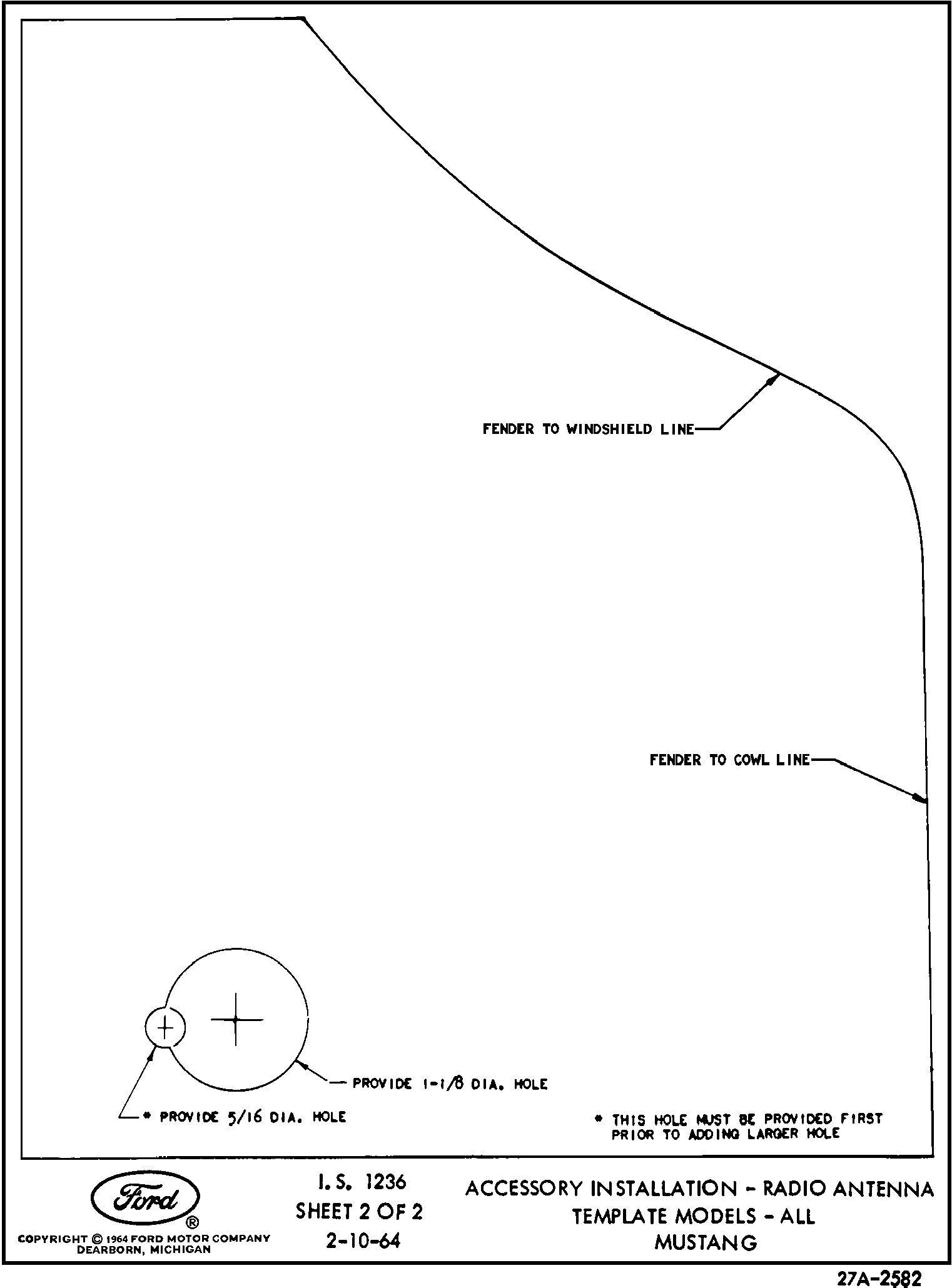

I am looking for a Antenna hole template.
 for 66 Mustang

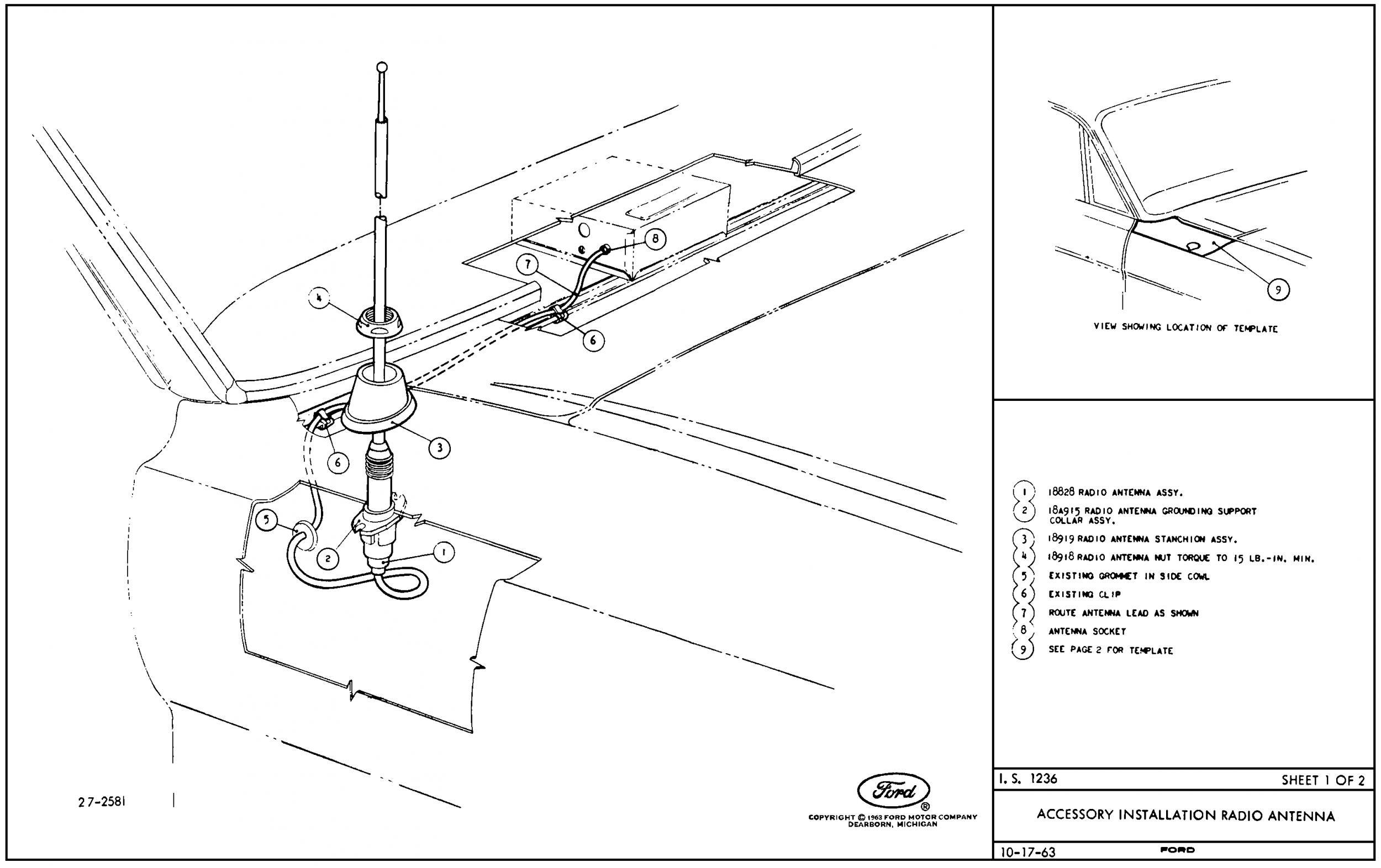

I saved those templates from Dave's site several years back. I've uploaded them to a gallery here on the forum. Here's the images:
