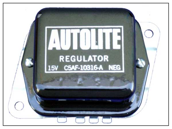

Just to clarify what you should be looking for in reference to a "bar" , here's a photo from the AMK webpage:
If you look closely you'll see the area below the plug is enclosed (the bar), as opposed to an open area. If yours is open, you don't have an AMK unit.

The Regulator is a Ford Licensed Piece and Max and are Marti is the only supplier of them.
Picture of Marti Autoworks Regulator

My regulator's stamping doesn't look like the Marti one in the picture-has the same words and numbers but is clearly from a different manufacturer.
Who is Max? is he the AMK guy? and why doesn't the mine have the solid bar across under where the plug goes like is shown in the other picture of the AMK units that JK provided?
Also: The Marti piece in the picture shows screws holding the cover on and mine has a type of pin....

AMK= andrer max kotlowski (sp?). i have seen early regulators with those type of screws. yours does not have the bar because it is not 100% correct.
