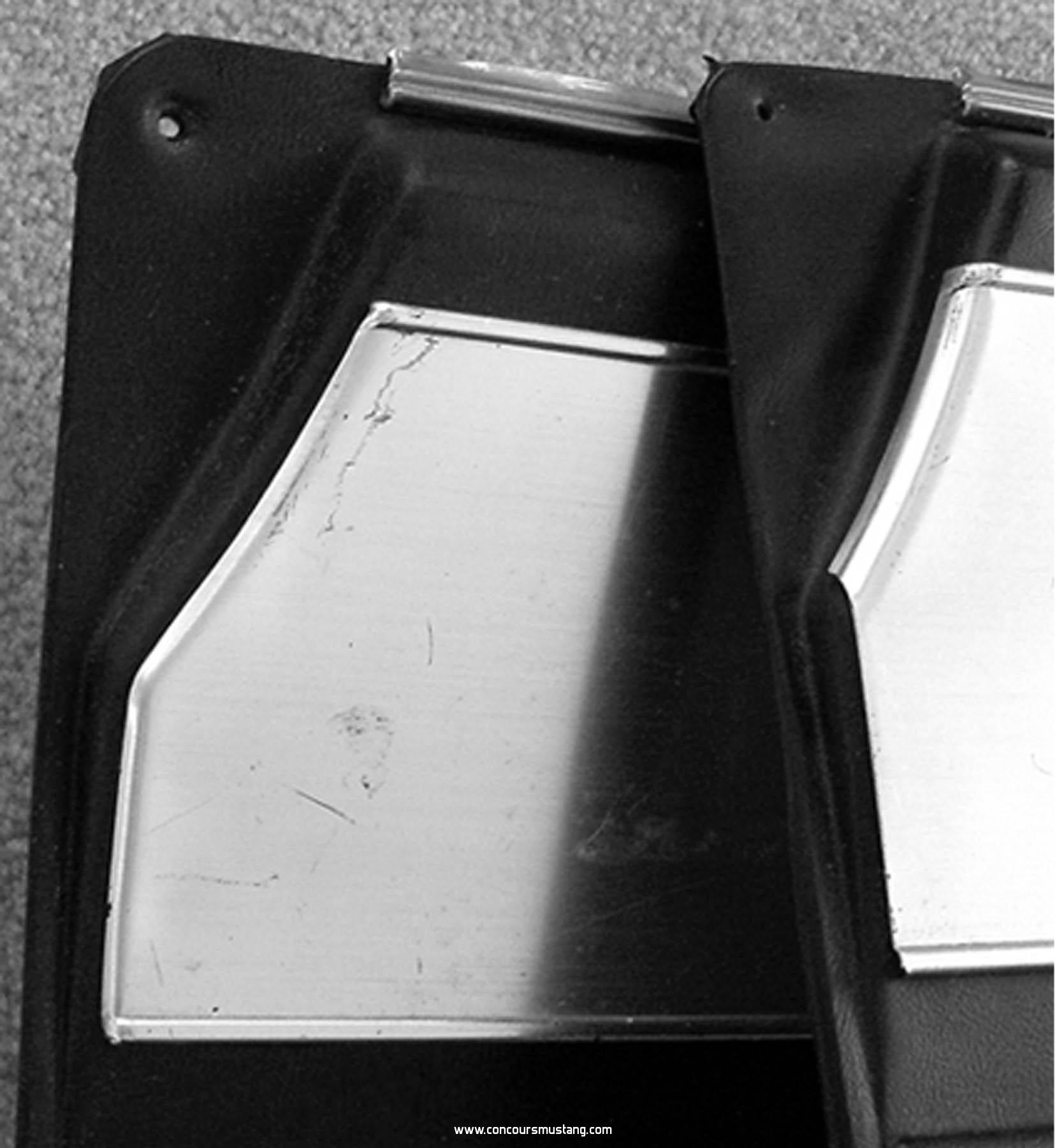

No, there is a difference in the forward edge where one is sharper edge and other has been blunted by the shape of the metal. Not sure when the change happened but best guess is around dec 66.

Would anyone happen to have pictures of the 2 different styles?  I have my original pieces, but they are scratched badly where the door handle is at.  I will dig them out and post a picture.

Guess I can jump in and help here. From a post on another site ;)
Early left - later right example

Thank you Jeff.  See attached picture but I seem to have the later design.  My car was built on Dec 17,1966 at the San Jose plant if this help determine when the switch was made.  Once again, thanks to all that jumped in.

Regarding the early vs. late Deluxe Door Panel inserts, looks like my car had the late version too - which means that the early ones must have been very early, as my car was built in Sept. 1966, and was one of the first 11,000 cars built in San Jose for the '67 model year...

I checked our originals from the SJ 11-04-66 and it used the late style as well.
