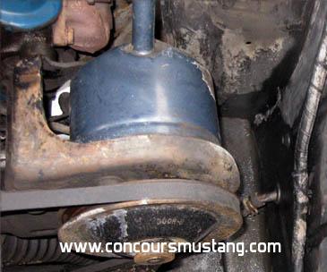

A couple - poor (sorry) pictures related to your PS mounting questions
Notice the LARGE round spacer between the PS bracket and head if your not running AC

« Reply #7 on: December 10, 2013, 08:06:38 AM »
I see the extra thick spacer.
I was also able to locate a correct PS, adjustment bracket.
Just want to point out that the 70 351W alternator head spacer bracket is unique to 1970 351W. The 69 351W used the same style bracket but they used different bolt sizes, IIRC larger bolts on 70, so they are different between each year.
Are you referring to the spacer in the attached picture (for reference only, not a 351W engine)?

Re: early 1970 Mustang with 351W
« Reply #8 on: December 10, 2013, 02:42:33 PM »
Yes, but the 69-70 version of the bracket behind the aluminum spacer shown in your pic. The spacer and bracket shown in your pic looks like the 71-Newer spacer for 351W. The 70 version would be a T-Shaped bracket that does not use a separate spacer. The reason for this particular bracket is because the 351W uses the same alternator brackets as the 302 and since the 351W heads are wider spaced the alternator long bolt would go right into the Freeze plug on front of cyl. head if there wasn't the spacer there to create a mounting point for the alt. long bolt. Here is a link to the 1969 spacer. The 70 looks exactly the same just with different bolt hole sizes.
http://www2.cougarpartscatalog.com/c9zz-0145-a.html
