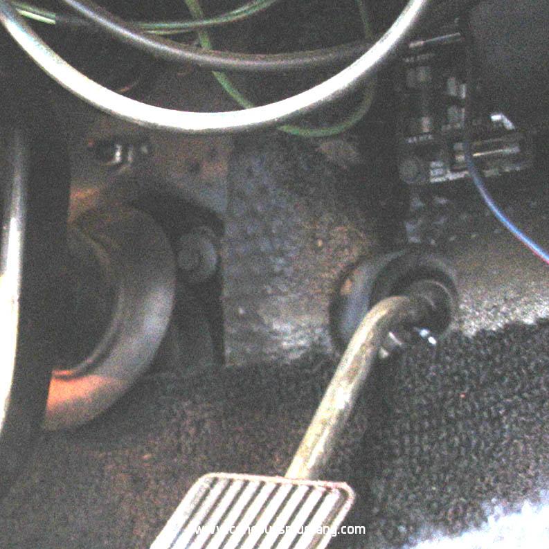

It is a bit blurry but the best I can do.

Thanks Marty!  I know the area is extremely congested and as suspected, I cannot really make out how the relay plate is secured to the wiper motor bracket (or screwed down to wiper motor bracket). It actually looks as though your relay bracket is bent out to more or less flat, taking the 90 degree bend as seen in my example out of it. (possibly for easier access to a failed relay?)  Curiously, I have seen this elsewhere in some pictures another member emailed me of his Convenience Control Details. Kinda like "Great, more confusion ???."  Nonetheless, the picture does show the same items I have on the relay bracket, mounted in the same arrangement (which I had also confirmed as the best possible match to what the assembly manual indicated along with following my rather lousy images I took of the area when I took mine apart)
