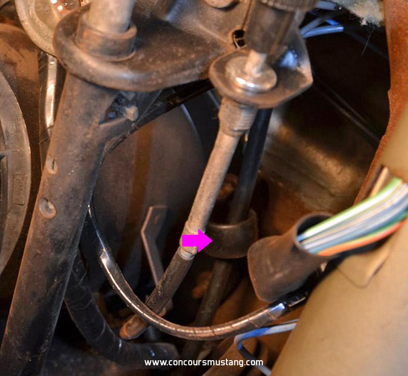

There are various bendable flat metal brackets under the dash to hold up wire looms and to prevent items from interfering or binding on moveable items. The Speedometer cable is run very near the clutch pedal and a bracket prevents the cable from getting fouled.

« Reply #5 on: November 12, 2021, 10:53:24 PM »
And the speedo cable bracket.
Let me know if I missed something. Lots of things going on ...

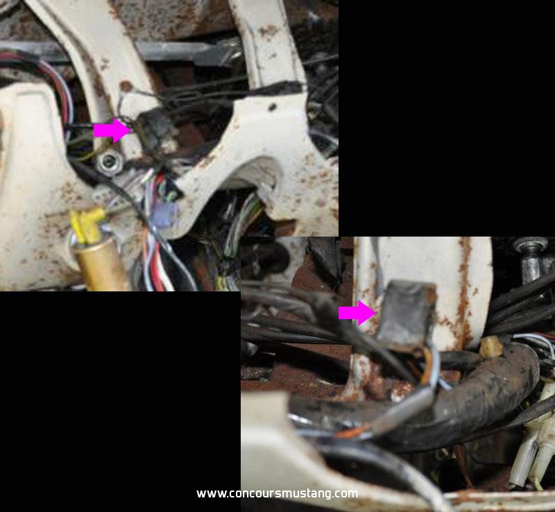

« Reply #7 on: November 13, 2021, 12:56:47 AM »
So, so far we have?
- Speedo cable supports  for manual transmission cars (1 ea)
- Dash main wire loom supports (2 ea)
NOTE: In this picture (a Dearborn car) they are installed upside down from how San Jose installed them typically
- Air conditioning dash duct tube supports (2 ea)
Sorry no clear pictures of these yet
This one also?  7R2074xx
Steering column is in the upper left corner for orientation I believe
