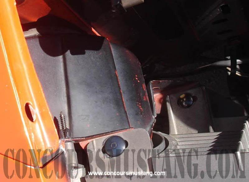

Hi, I have seen a few pictures of the fender extensions on what I believe are Dearborn built 1970 mustangs blacked out behind the grille area.  I'm wondering if this is correct.  I have a Dearborn built 1970 Mach1, yellow, built 4/70.   Any insight on what areas either behind the grille, headlight bucket or both should be blacked out and what application method, sprayed or brushed, is much appreciated.

Re: 1970 Dearborn Mach1 Fender Extension Black Out?
« Reply #3 on: May 03, 2014, 06:31:22 PM »

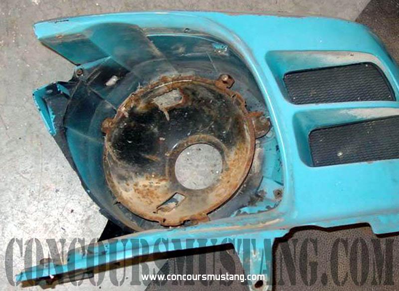

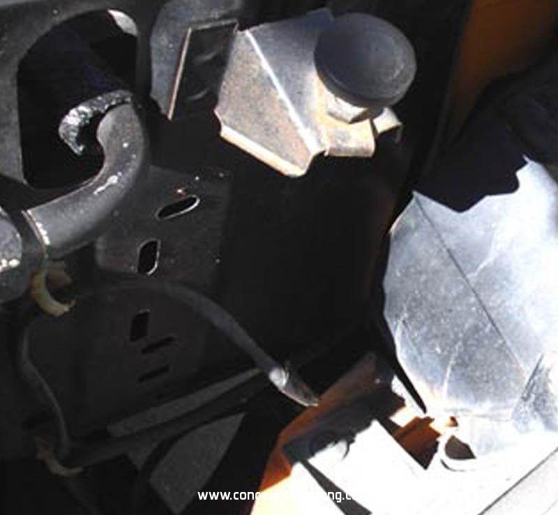

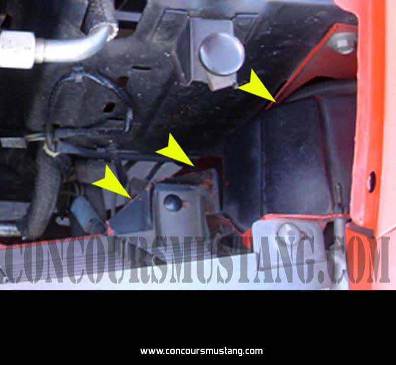

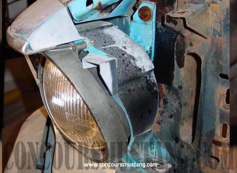

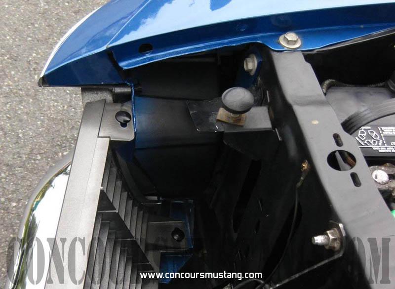

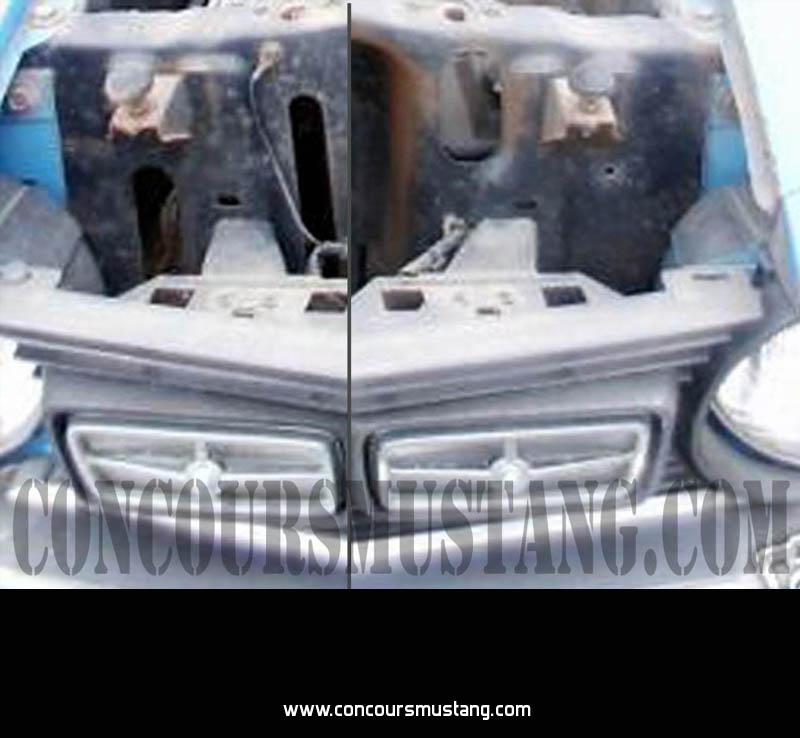

Here you go  - hope this helps
« Reply #4 on: May 03, 2014, 07:27:22 PM »
Thank you Jeff, very helpful!!  Definitely looks like that was sprayed on and looks like a satin sheen, like the engine compartment.
Steve
« Reply #5 on: May 03, 2014, 07:31:58 PM »
Yes applied before they were bolted to the fender. Not sure of the sheen - after all these years of exposure :(  But very likely something in the semi-gloss black range of things
