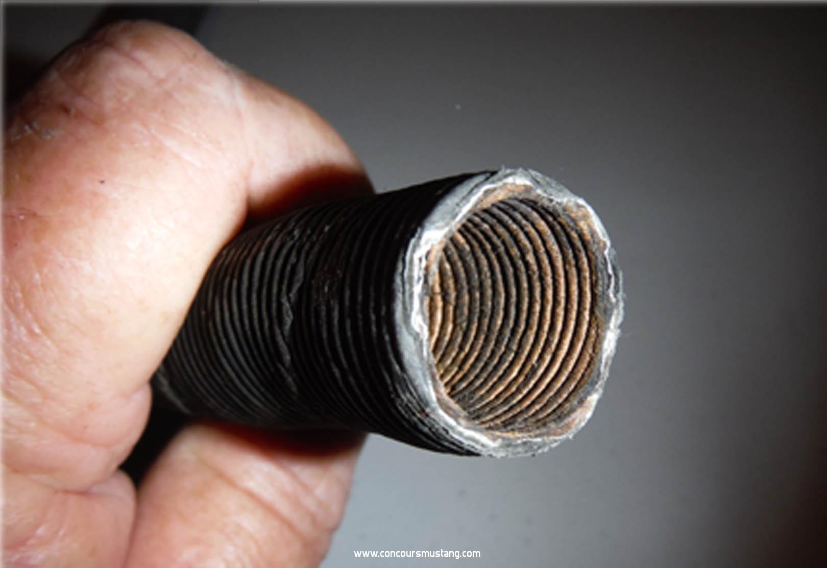

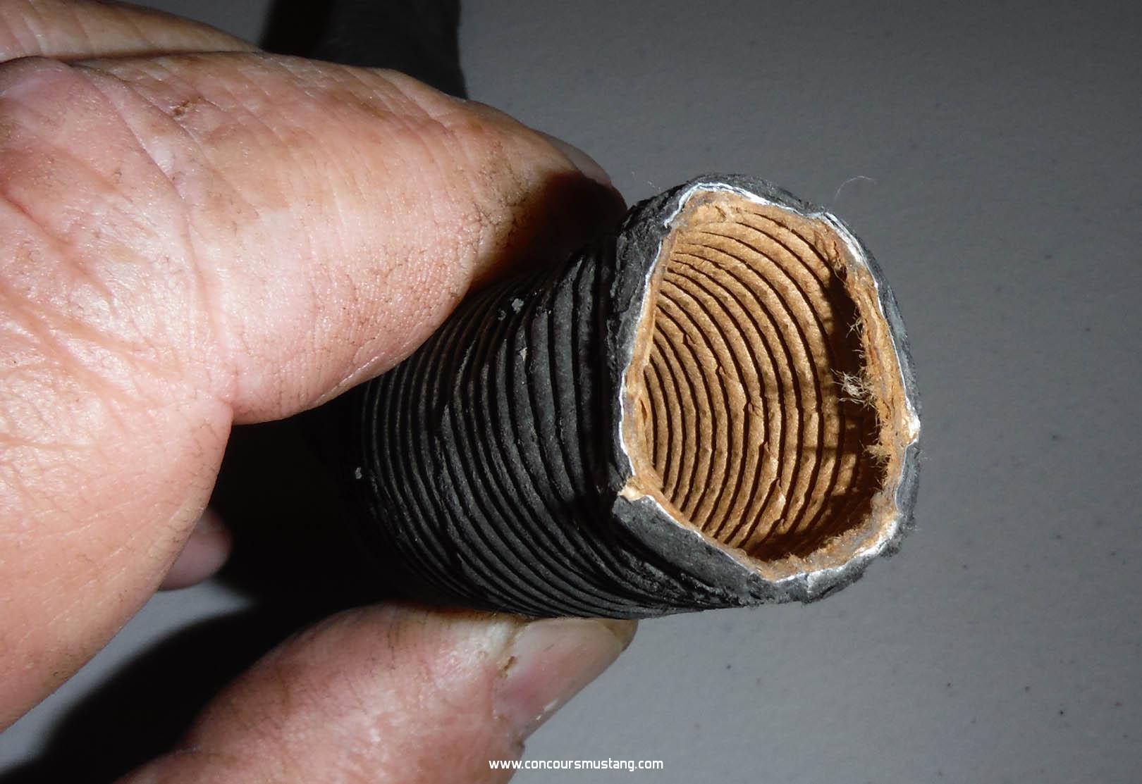

Here is a shot of one (as promised)  I took from a Mustang - have six others that are of the same material so likely its not a service part
Clean canister end
Dirty :( from the air cleaner end and use. Seen them really bad when the owner had an engine with allot of blow by

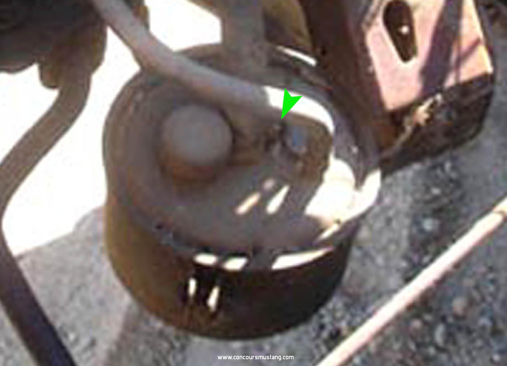

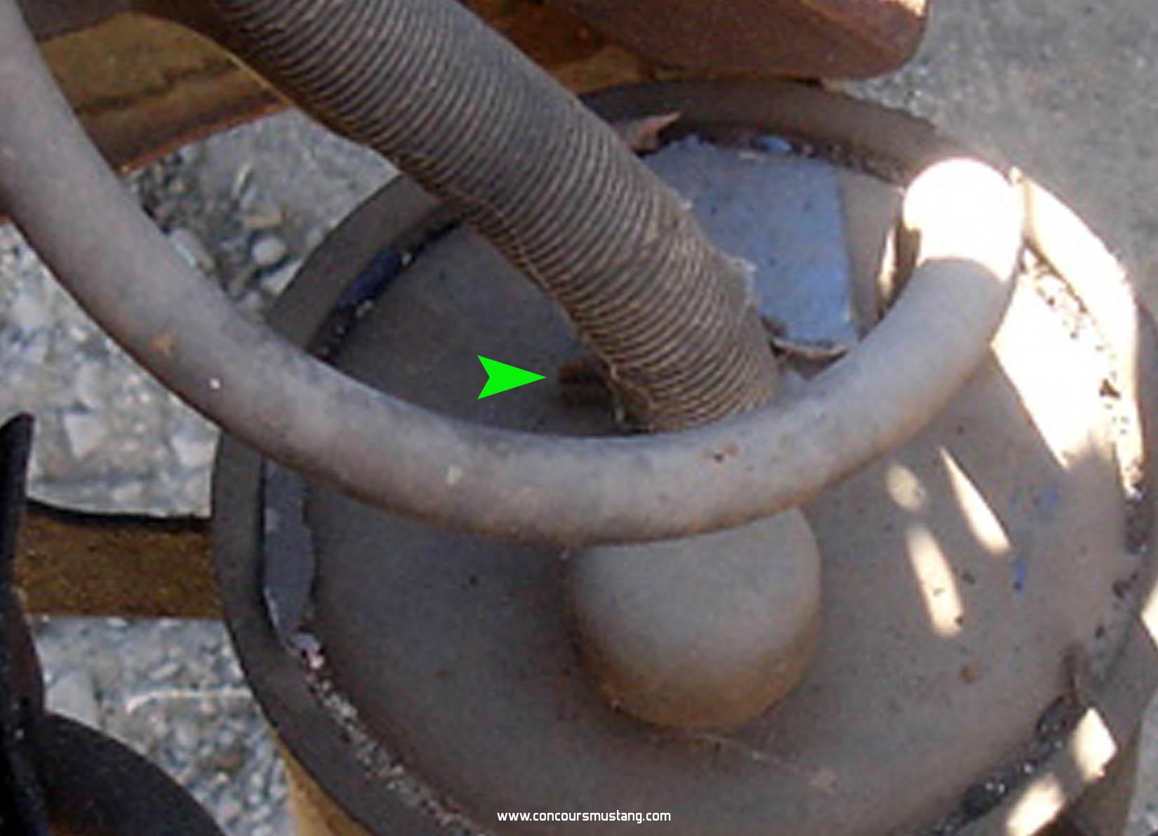

Ok, while we are on the subject of the Paper Vapor Tube, what are the correct clamps for holding it in place at both ends?
Don't recall ever seeing a clamp used at the air cleaner end on a 70  And didn't remember one at the canister until I checked my pictures. Guess I've got them for a reason ;)
Sorry they are not very clear but here is what I've got
70 Dearborn  - Arrow looks like it may be the end of the stud from the bolt of a clamp
70 San Jose - Arrow points to what appears to be the hex head of the tightening bolt of a Witik clamp
What I've got so far.
BTW each shows the same tin foil - covered by paper tubes shown above
« Last Edit: May 05, 2014, 09:55:41 PM by J_Speegle »
The ones I remember from out of so.Cal. area, the clamps were a smaller version of what was used on 66-67 Thermactor Hoses, I suppose they were Wittek, never checked for a name. A (5/16"?)hex head with a slot to tighten them as I recall. Correct, clamped only on the canister end and pushed onto the plastic nipple in the air cleaner.
