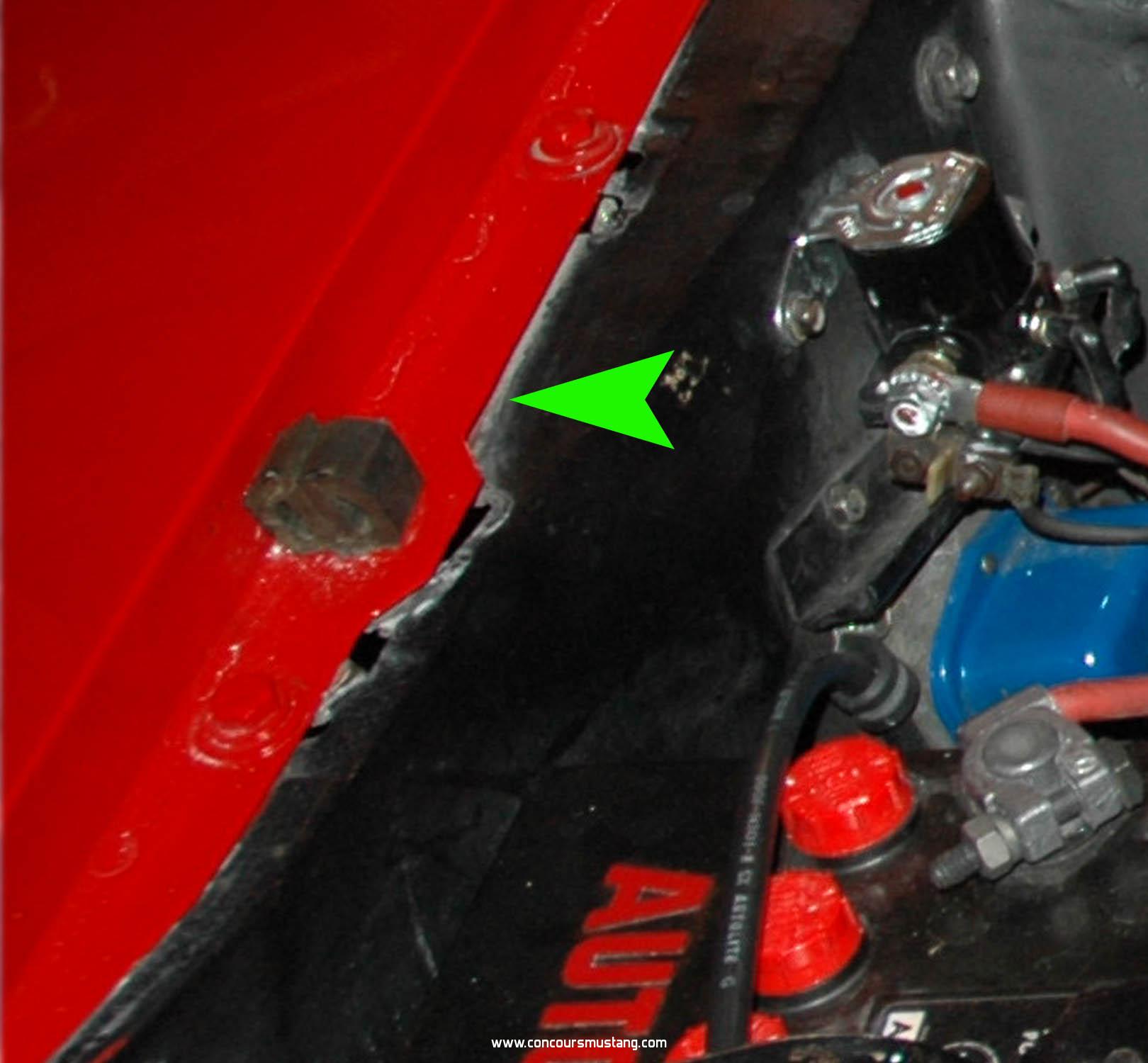

Fender sealant? What is that?
Sorry in the picture without enlarging it it looked like the sealant (black chalking that went between the fenders and inner fenders) was light gray. A common mistake. Enlarging the picture I can see that there does not seem to be any sealant and its just the gap between where you painted and the fender - the old dirty surface is showing
Ok...so what sealant do you recommend that I get and how do you recommend that I go about applying it so I don't screw it up? I have always wondered if I could close the gap between the fender and the engine bay for a better look (but I have been afraid to). Now that I know that sealant is used...I want to get it correct.

2- Replace the fender sealant with black 3M strip chalking ......................
