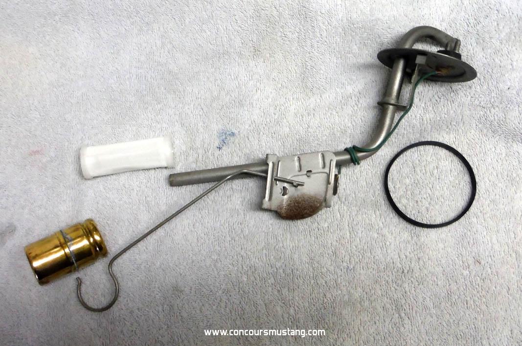

Just happened to have ordered and received one of WWC refurbished fuel sending units last week for my Cougar. I understand they clean and test each unit then include a float, gasket and screen for the price.
Here is what you get.
