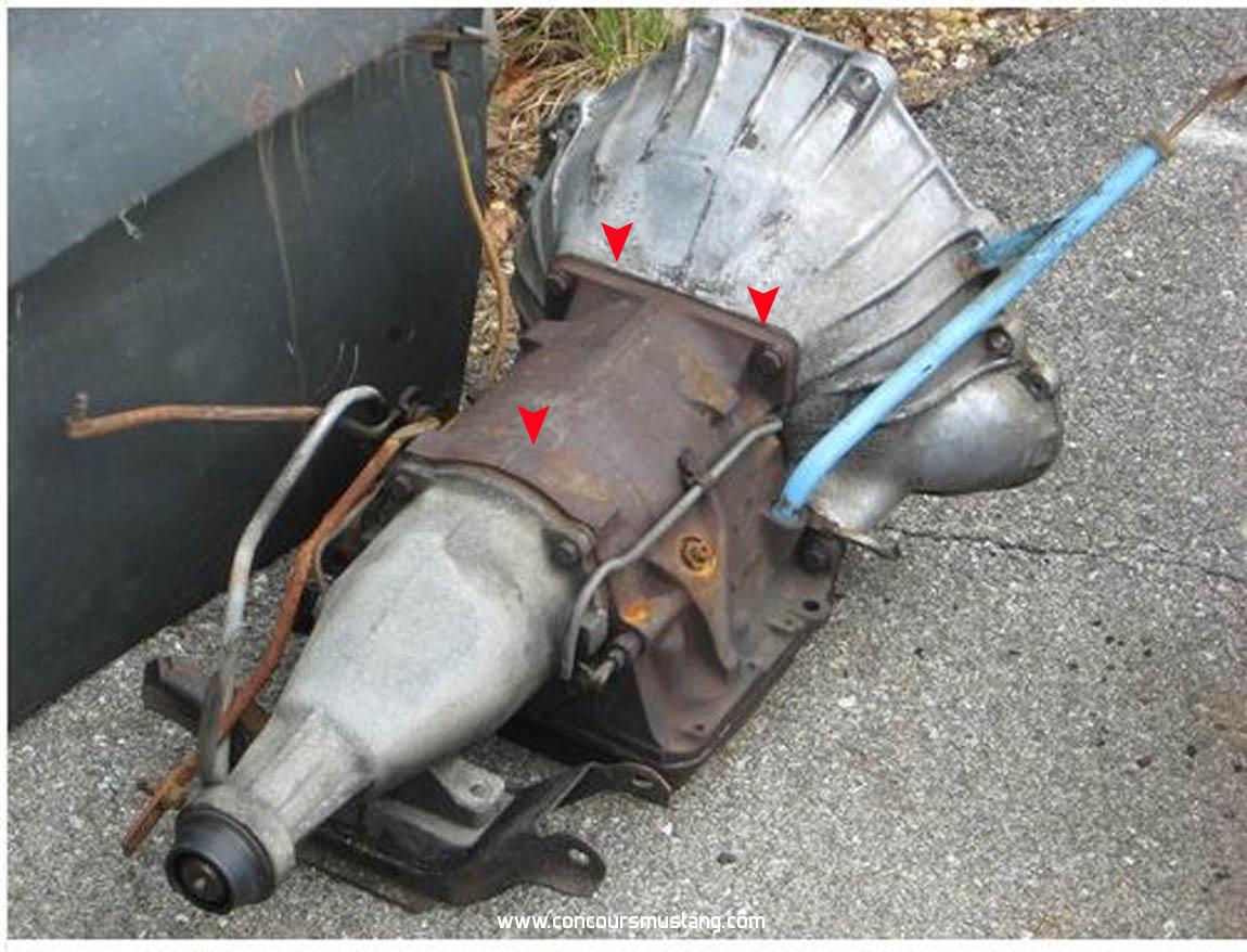

Its was applied to the top after the engine and trans were mated together I believe . This made placing it on the bottom a bit difficult
Will look through the collection to see if I've got a good picture - as you mentioned C6' sand C4's were on top also

Jeff, many thanks for your prompt reply!  I would be most grateful if you could post a photo showing an FMX with the location of the boss where the VIN was stamped.  It occurred to me that I could use the ‘snake scope’ we have at work, and knowing where the stamp is located would help me navigate the camera to the correct location.  The car was purchased with the understanding that he drivetrain was original, and it’s only the tranny that I have thus far been unable to verify as a match to the VIN.

Looked - no luck :(
Guess I need to look for some at the next yard visit  or around the shops
IF I was looking for it - I would guess that I would start at one of the locations pointed out below. It will be the short VIN version like on other types of trans stamped with the VIN in 69
If you knew where the VIN was stamped - the low tech method of using PlayDoh
 works pretty well   I use this method when I'm doing vehicle inspections

Hi again Jeff,  thanks so much for your efforts.  They are very much appreciated.  The PlayDoh suggestion is a good one.  I'll try the snake scope first as I can do this without getting right underneath the tranny.

Believe you will find that the aluminum automatics will have a clearer and deeper stamped VIN  but as Brian showed cast iron cases make it more difficult to stamp and because of the textured surface more difficult to see often. Since the main case in an FMX is cast iron its a good representation of what your looking for
Need to correct my earlier post above. You may find the full VIN stamped - apparently (looking at my pictures) not all of the plants used the same pattern asa the others - go figure :0
