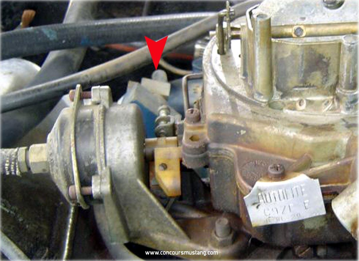

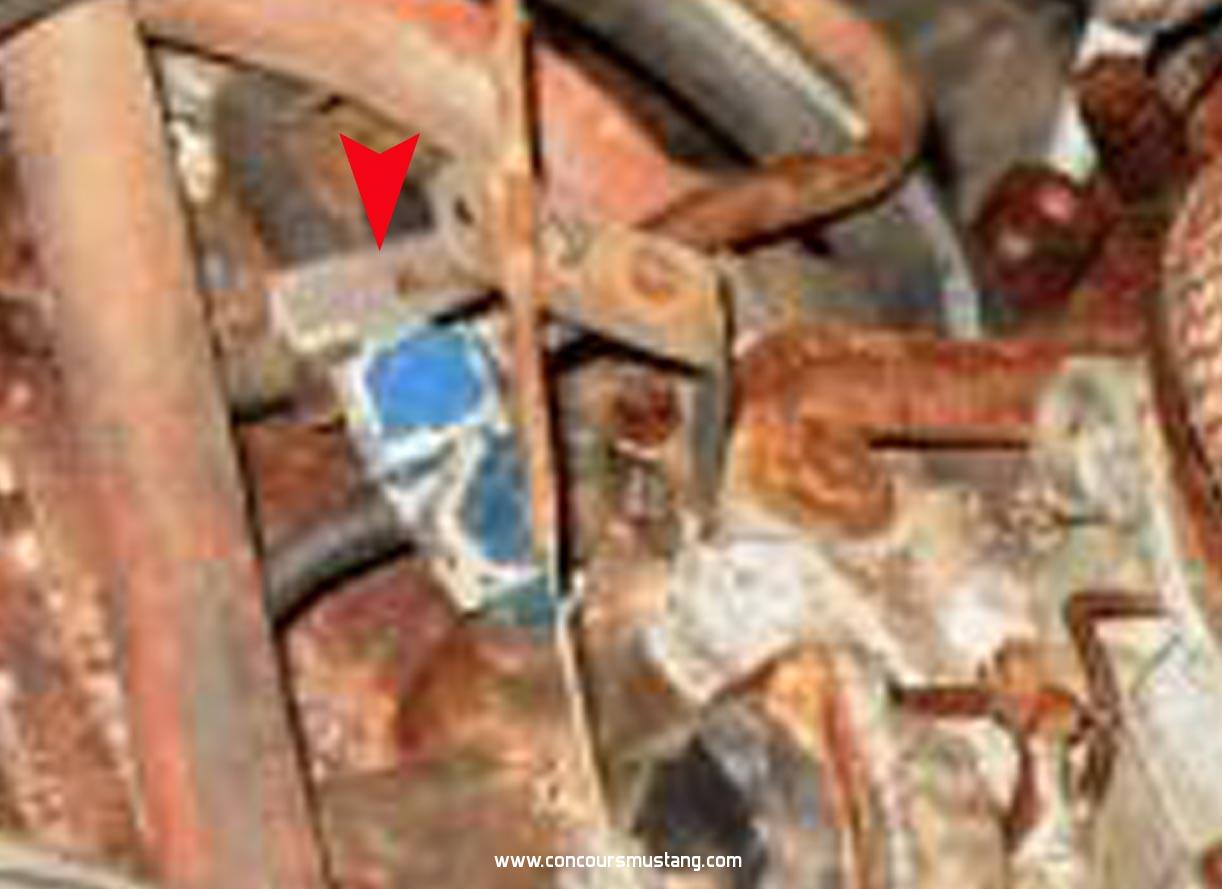

I am looking to add the original intake back on my 69 Mustang but I'm not sure if I need a Distributor Vacuum Control Valve and am confused about which intake vacuum port I would need. Some info about my Mustang that may help:
- Built April 8, 1969 in Dearborn
- 390 4 speed car
- DSO in New Jersey
- Power steering
- Disc brakes.
1. Would I need a Distributor Vacuum Control Valve installed in the thermostat housing?
2. Based on the options I listed above, which intake vacuum port would I need from the pictures below?
Thanks.
Since this is the Concours site  - of course you would/will since it would not be restored without it
Also referred to as a PVS Ported Vacuum Switch
The vacuum tree that you posted would attache to the other larger vacuum block at the rear of the intake
Closest match I have is a Non AC, PB, PS  manual trans NJ 69 From the 9T01S151xxx  period
And a Dearborn examples (ignore the PO manual choke upgrade :)
Both cars still have the Autolite 4300' s so not allot of things have been done to these cars. Not restored by a long shot
In both it appears that there is a single hose attachment at the rear unlike the one you posted which has two hose connections

That brass block was added after engine was painted & should never be painted & different types depended on options p/b tilt shaker a/c etc. but the 1 you have in picture is most common.

I contacted Mansfield Mustang about which intake vacuum port would be correct for my application. The picture posted on their site shows a brass block with a threaded hole on one side (maybe for the disc brakes) and two other vacuum ports like the picture of the brass block I posted. Mansfield told me a Mustang could have come with a brass block from the factory with additional ports and if some were not needed, they would be blocked off with a rubber plug. He told me they grabbed whatever was available at the time on the assembly line.
Most of the brass blocks I have seen for my Mustang come with the two vacuum ports and a larger threaded hole on one side. I have not seen a brass block with only one opening as were posted in Jeff's pictures, but I'm still looking.
