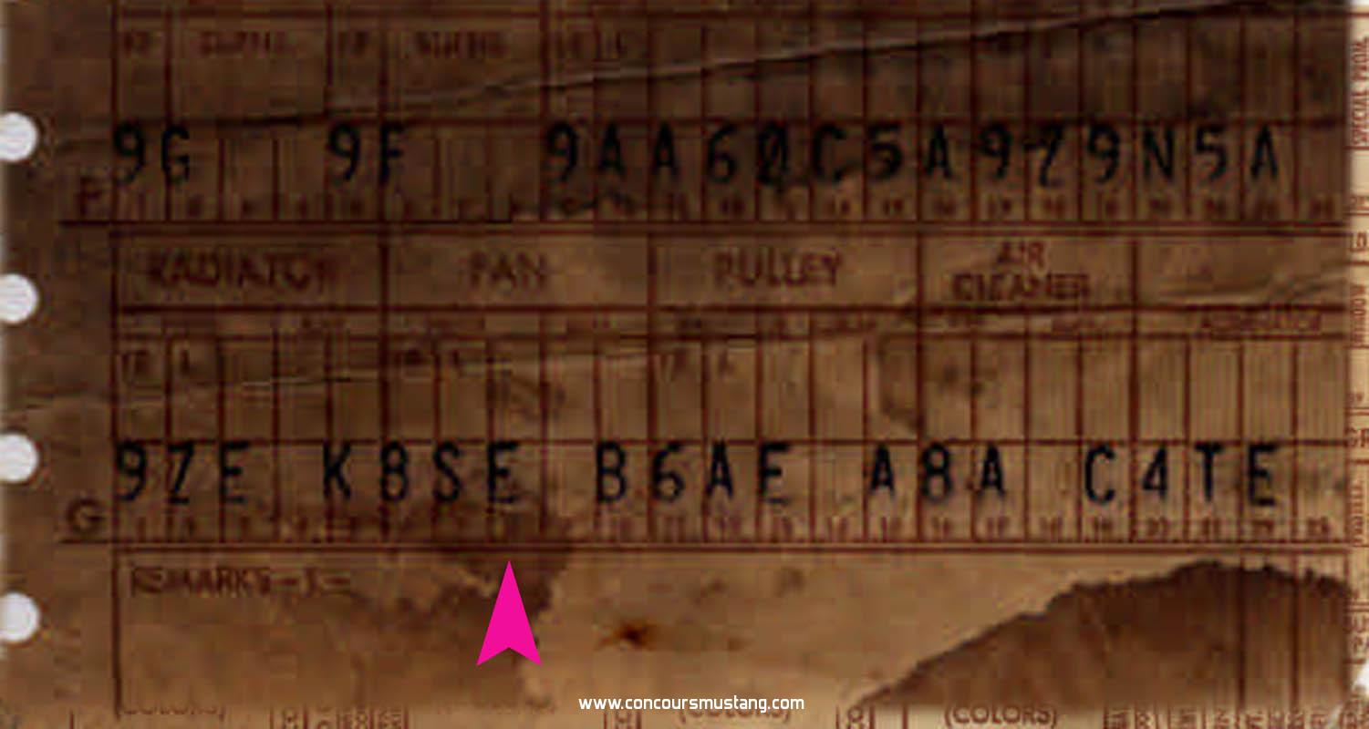

Hi guys, I recently had some good friends who are certified MCA judges come by and check out my '69 Mach 1.  I'm getting it ready for the Savannah MCA show in October.  My car was built in June '69 at Metuchen.  It's a factory air car, with a 351W and automatic.  The car was disassembled when I bought it, so there's not a lot of references to go by.  Since my car had factory A/C, would it have had a fan clutch when it was originally built?  Right now, it has a fan shroud, but has the standard fan extension instead of a fan clutch.

No clutch fan on that application (thought we covered this in another tread) In later years its not a direct - all AC cars get clutch fans and all non AC cars get non- clutch fans
Buildsheet sheets indicate the original fan which confirms application and the type ;)

Ok, so the car is correct then.  Given how rough of a life this Mach probably had, I'd say that original buildsheet ended up in the trash by about 1971.   :P
Re: '69 351W w/factory air: Fan Clutch or Not?
« Reply #4 on: June 25, 2014, 02:01:35 PM »
Here is a cropped buildsheet that you should be able to use as documentation - need more just let me know
C8SE-B  - hope this helps.
Great, thank you!!  I'll double check what's on the car, but it seems like it may very well be the correct setup.

Great hope so - another thing you'll not need to find or look for
For others it appears that the fan is a T-bird piece and was used on 69 Boss 302's also
