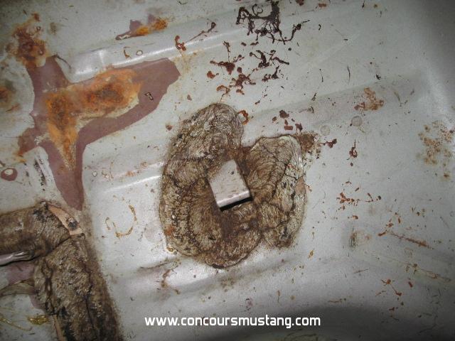

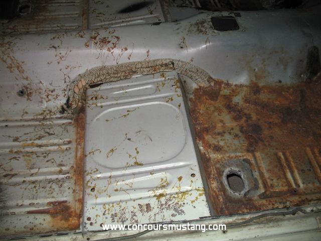

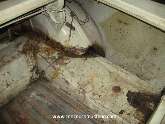

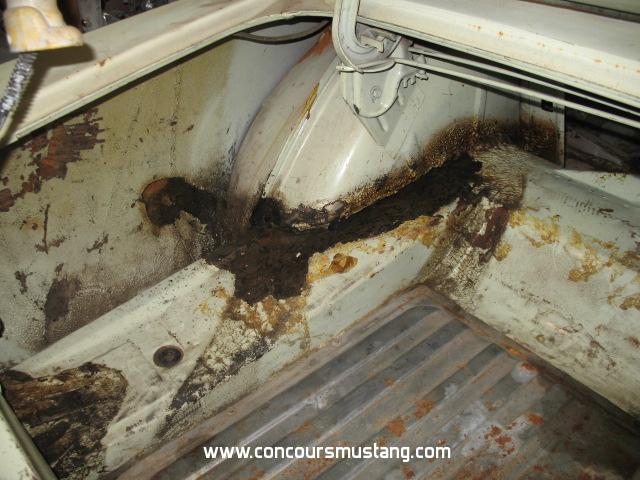

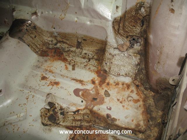

Looking for some input on whether to replace all the sealer or just where it is bad and missing.  I was originally thinking to replace all of the sealer because it is loose in some areas.  My thinking now is to remove the bad areas and infill with new sealer then coat all of the seams with undercoating to ensure a water & dust proof finish.  I've included photos of various areas and condition of the sealer.
That is the best way to go. The purpose of seam sealer is just that, to seal the seam from moisture and dirt. In visible areas, like the trunk, consider removal or at least cover any existing sealer that is not removed, just to be consistent.
Re: Seam Sealer
« Reply #2 on: March 29, 2014, 05:29:24 PM »
IN the interior only I would leave the original in place and if cracked or damaged overcoat and or repair with new. I would not expect the original product to get any worst considering how the car will be stored and cared for in the coming years
In other areas only seal what originally was sealed and unless you believe it might be hiding rust or other issues do the same since its often difficult to reproduce the finish and look with newer products

Thanks guys for the advice, the floors look really good compared to my last car it didn't make sense to me to tear everything out.
