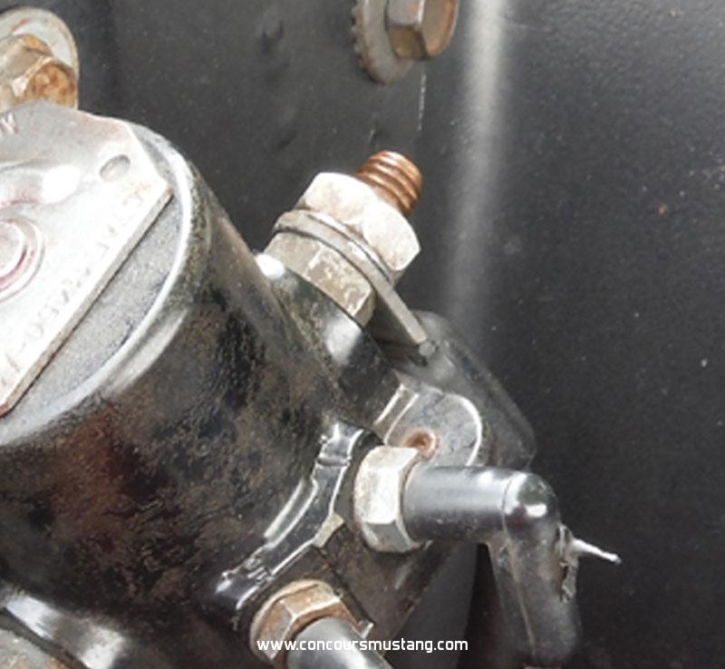

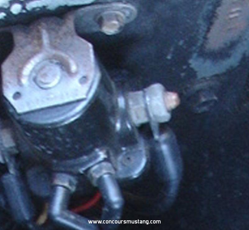

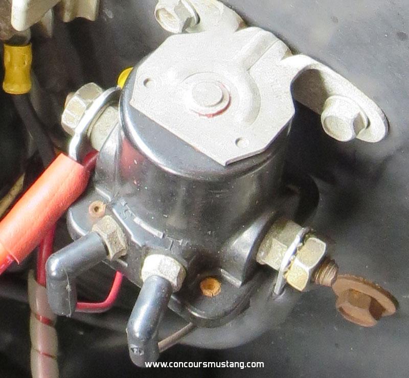

Some examples from the photo collection - all 67 San Jose this time
Below is not just another picture of the example above though it would be easy to assume it was.
Looks like there is a possible lower (metal section) scallop but typically the rubber comes up far enough to hide it or hide much of it
Hope this helps illustrate what I found. Sure there are more examples
