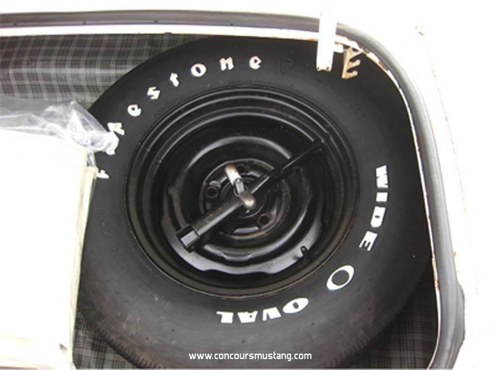

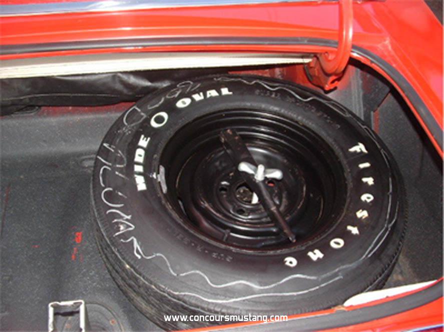

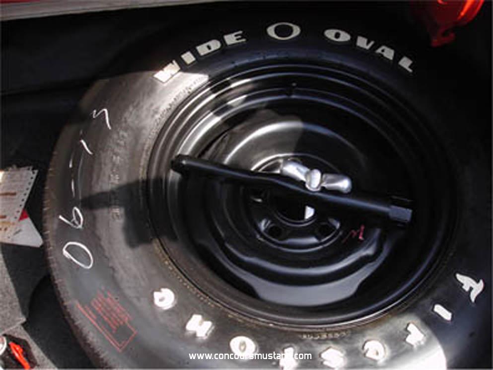

Not my area of focus but lets see if this will help. Fair number of loaded up 73 convertibles unrestored around, when compared to other years and models since a fair number of people bought them and put them away - last Mustang convertible and that sort of belief/thought
Here are three unrestored examples (cars with the forged wheels)

Only have an invoice from another forged wheel 73 it shows the wheels and tires as being (5)F70x4 Wide Oval Belted BS Tires/Raised White Ltrs  for about $73
Don't recall a Uniroyal like your ever on a Ford originally but that is just me. Even if they were original its apparent that they would likely not be correct for a car with forged wheels
May be then it would be more appropriate the wide-o-oval.
We've got four unrestored 73 suggesting IMHO that
My spare has also the lock, needing a key. I wonder why mine is mounted upside down compared to your 3 pictures ( valve not visible)?
Looks like your car as a shorter J hook. Appears that the lock would work with the spare the other direction but don't know if the lock can use the original J hook diameter or needs a different one
So you confirm that a steel wheel is std supply when using forget alu. wheel?
Yes that is what the cars and paperwork we have so far shows
What would be the meaning of the color spray dots on the wheel?
Identifies the style and size of the steel rim for workers on the assembly line. Pretty typical practice for decades
