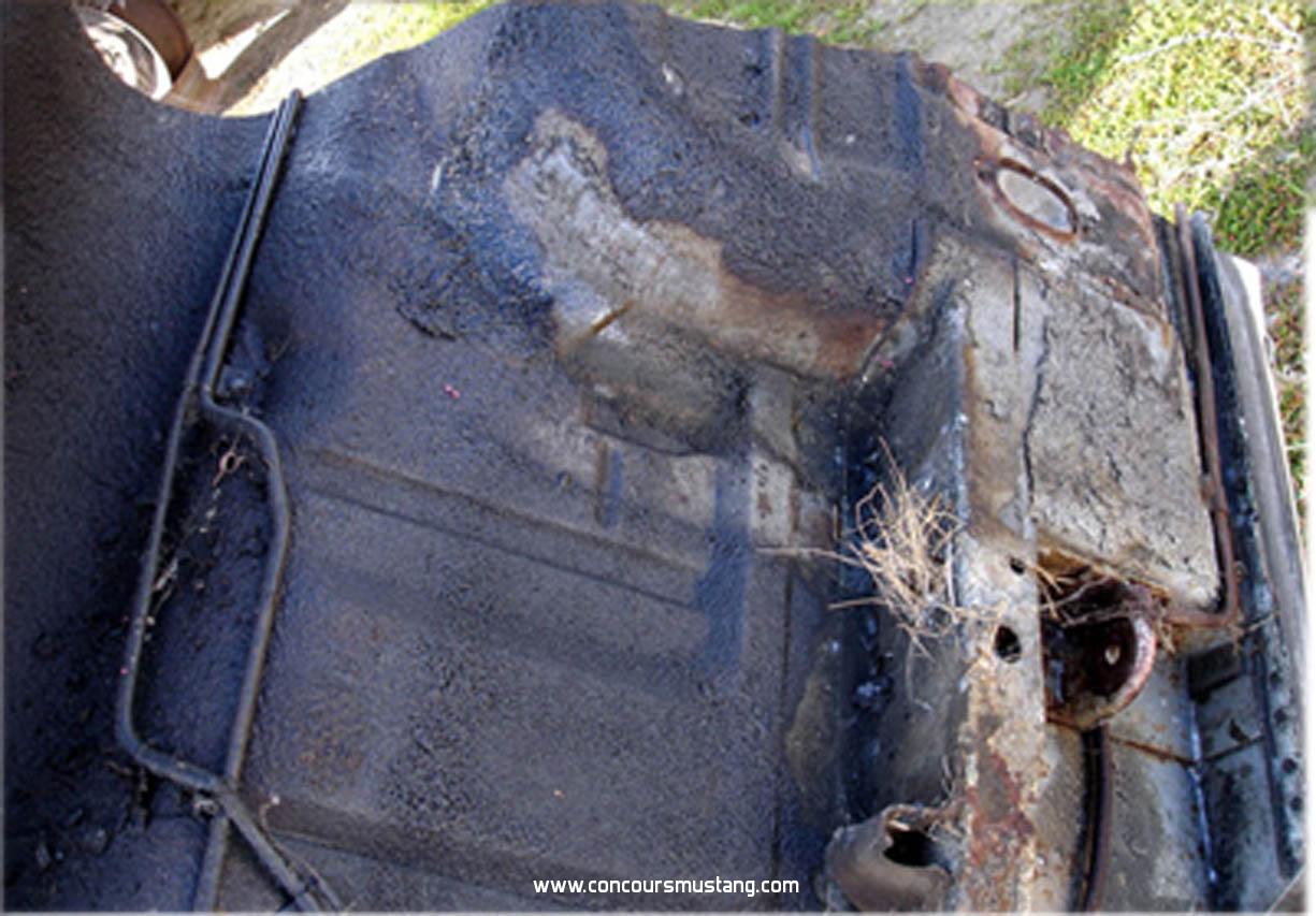

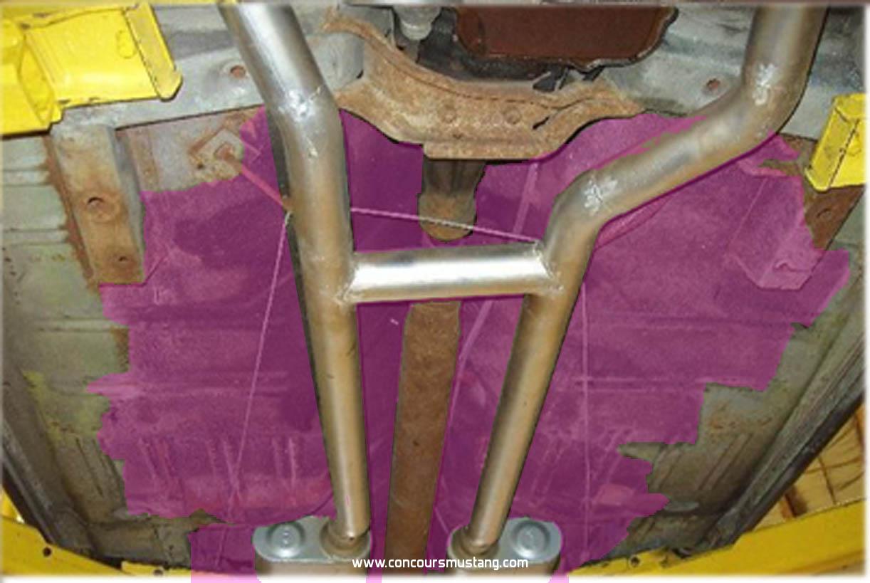

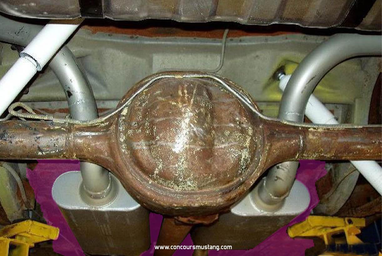

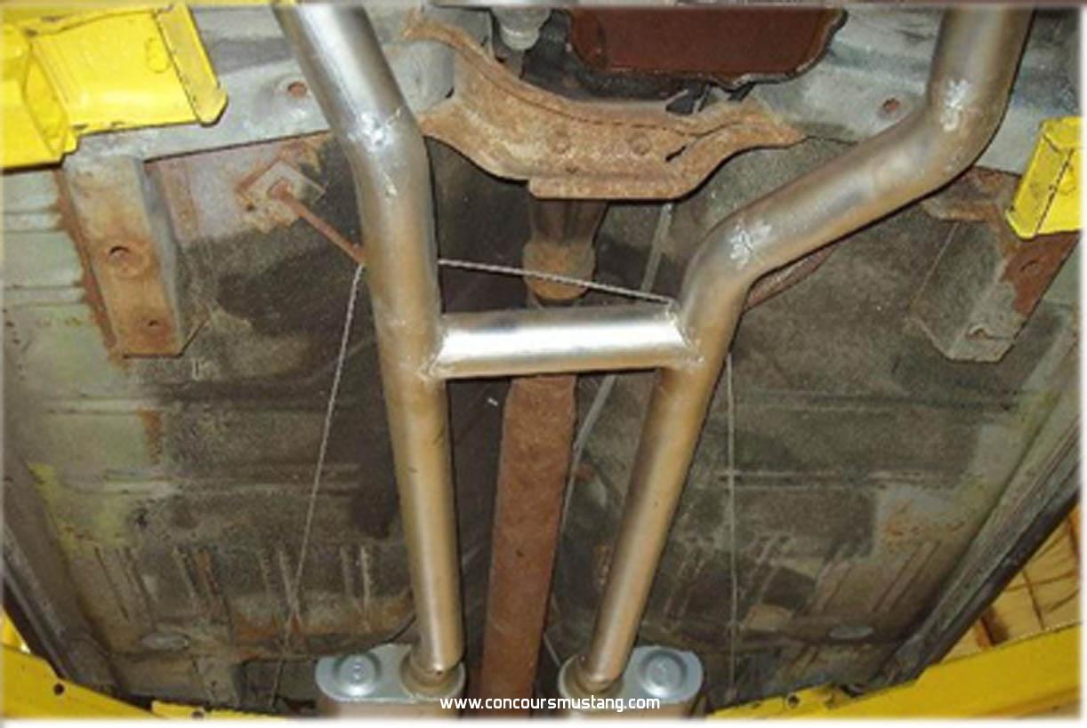

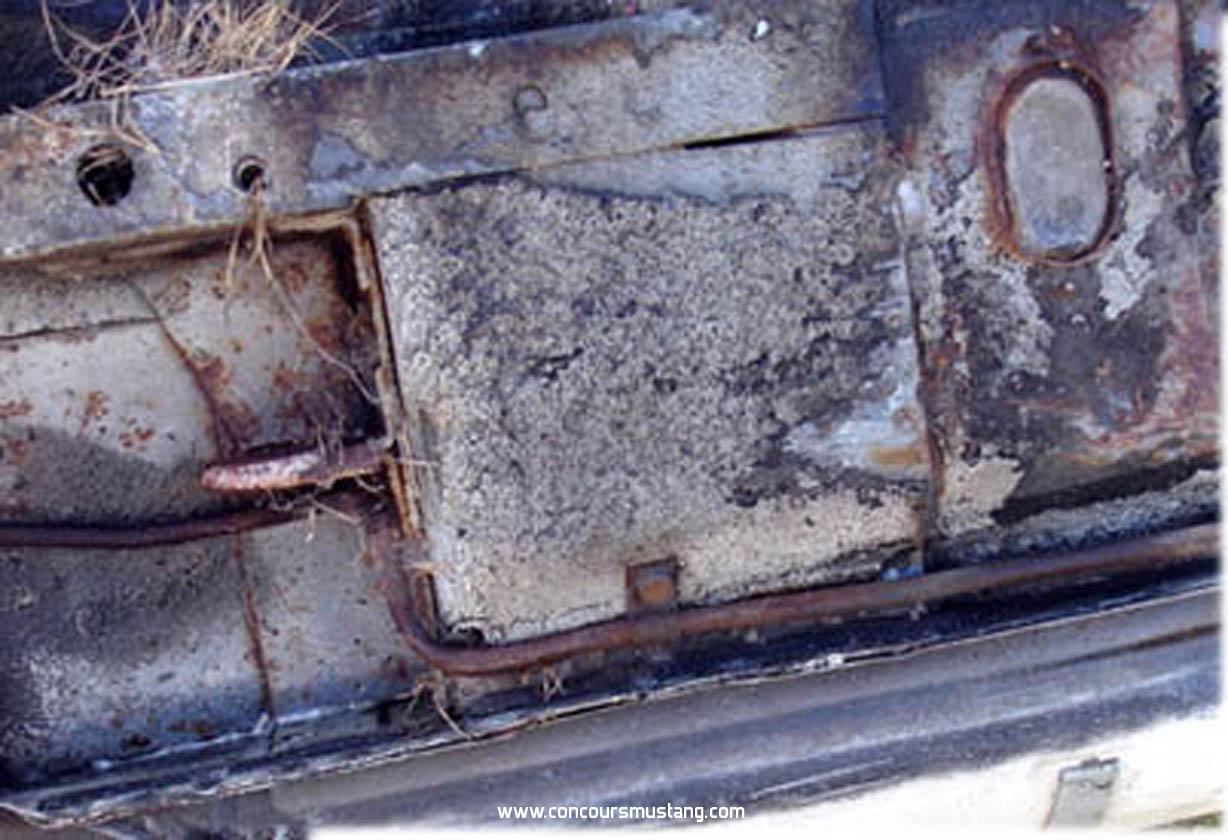

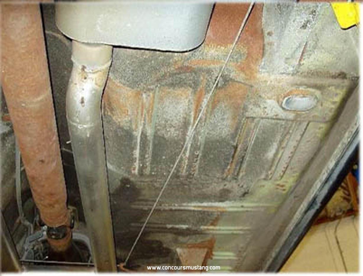

« Reply #7 on: September 19, 2014, 06:30:31 PM »
Sorry this took so long - later stuff is a bit more difficult - didn't forget you
As typical we often find that there is a range of how much was applied and where it was applied. Often the range falls between a little and allot ;)
So here are some original pictures (some highlighted for visiblity) one example where the pattern is much closer to the outside rocker panels while others as about 2/3 of the way.  One being applied across the floor pan while on the other no visible (allot more product appears to have been applied) pattern
Example #1
Example #2
