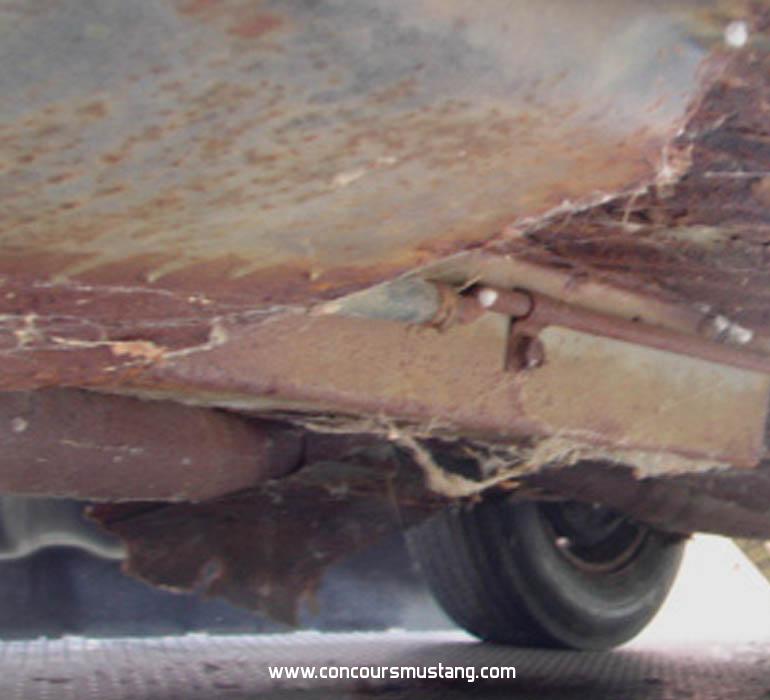

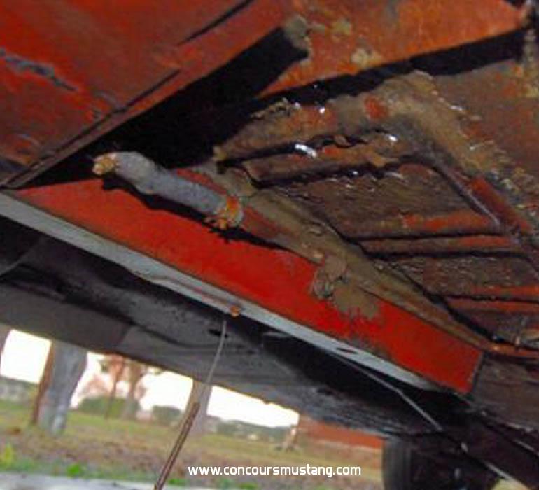

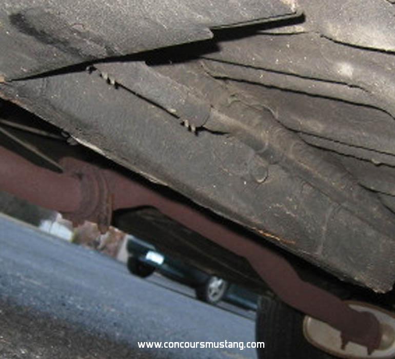

Crusty originals - All later cars

You might want to start a new threat focused on your need and year - As the wording of this post might not be the best first post of a new thread ;)
Have tons of original car pictures of this detail once you get it going
