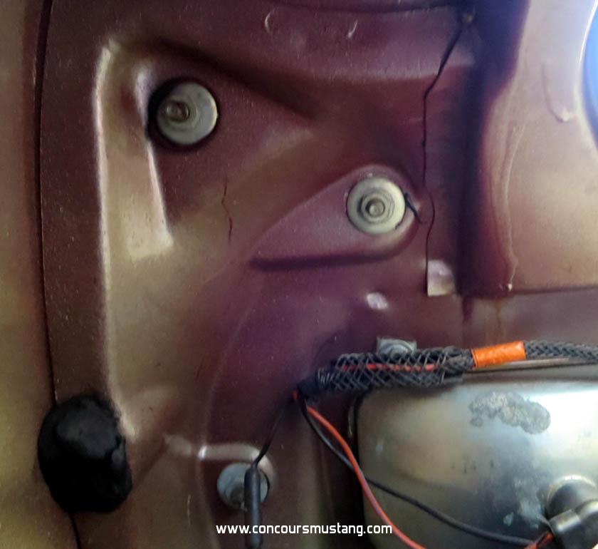

Are you referring to the washer that is part of the nut assembly that attaches the quarter extension to the car ? If so the sealant was on between the back of the nut and the body and was compressed as it was tightened Don't believe the sealant was made and applied to the back of the washer and delivered to the factory that way. The sealant on the washer you are showing looks like its been applied to the back side and rolled around the edge as it was compressed. Just add the 3M product mentioned below and install
Also, on my car, it looked like there was some kind of sealer or rubber bumper on the edge of the car for the quarter extension.  Anyone know what this is?
If your not building a 64 1/2 then there should be a small thin weatherstrip channel around the outer edge of your quarter extensions that held a thin rubber strip. These are available in reproduction from most parts shop.

Thank you Jeff.  Yes, mine is an early '65.  It is a transition car, but with many more of the 64 ½ parts than '65 (door tag says 9/11/64).  I do have the nut assembly that your picture shows.  However, I dug out a flat washer inside of the conical washer/nut.  The sealant could have very well squished behind the flat washer, but the sealant was all the way behind the washer (no voids).  What really puzzles me is why there is a flat washer to begin with.  Any ideas?  I am 99% sure that it came from the factory like that.  The car has been in the family since new and I know its history.
My extensions do not have the channel for the seal, that's why I was wondering what the blob of rubber or mastic was in the hole on the edge of the quarter panel.  In your picture, it looks like you have it too!  Bottom left in the pic.  Any idea what that hole was for?  Is the mastic applied during or after install?
What assembly plant?
Could just be a worker that placed them there on their own or a practice that was used and later dropped when it was determined that it was not needed.  Did you look at the unibody (don't know where you are in the build - sorry) to see if there was a strong coat of paint under where the extension would be installed or if there was a shadow in that area?
Not sure why the engineers put the hole there might be for alignment in a jig used to assemble that panel and one or more - making it a sub panel that would have been added to other panels during the assembly of the basic body
Unibody was sealed, primered and painted then the blob of mastic was applied not that particular lump is not painted. It is unrelated to the style of end caps

On the unibody where the extension mounts, it looks like a light grey primer and an outline of color (poppy red).  Looks like the extension was installed and then painted at the same time as the  car as a complete assembly (see pic 2)

I believe the original washers/nuts had sealant applied to them and were delivered to the assembly plant that way.  Had some very old NOS service replacement quarter extensions and had the nuts that way also.  Keep in mind that there are 2 styles of the nuts, 65 and some or all of 66 is smooth about the washer edge, plain zinc or cad plating.  The later style, like which would be found on 67-78 are zinc with dichromate and have wavy edges.  Bob P has a big bucket of these from the Dearborn assembly plant.  AMK also makes a nice reproduction, but unfortunately, sell them as "correct" for 65-66, which does not match what I've seen on original cars.

Thank you Charles.  I'm lucky enough to have had this car in the family and know that most of all the hardware is factory.  I do have the wide washer that is attached to the nut.  The washer has smooth edges.  I'm going to go with Jeff's suggestion and use the 3M strip caulk.  It looks like it's the same material.
I have a hunch that the factory had precut mastic to fit the stud (AMK has "mastic washers") to help speed up installation.  I've got time, so the strip stuff should be good

If you use strip caulk on the face of the nut washers, I recommend to roll out the caulk and cut "washers" to match the diameter and 1/16" - 1/8" thick.  When tightening, this will give the desired appearance with the caulk squishing out.
