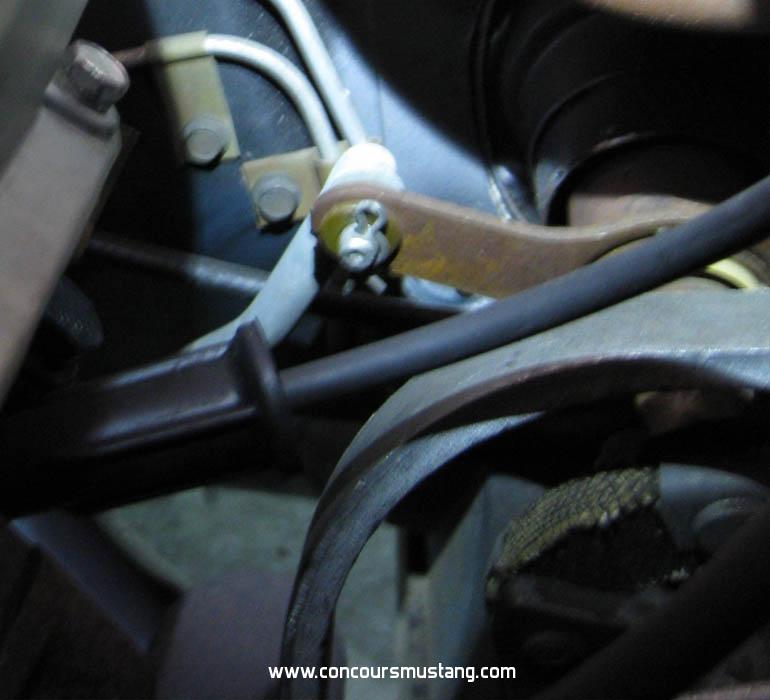

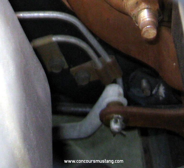

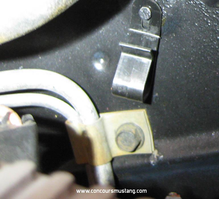

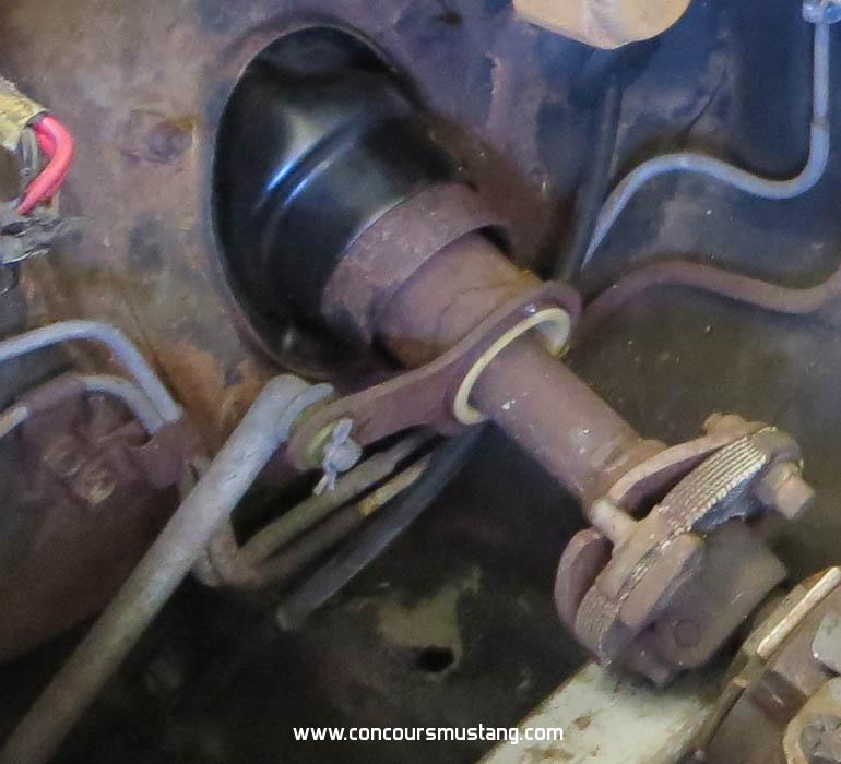

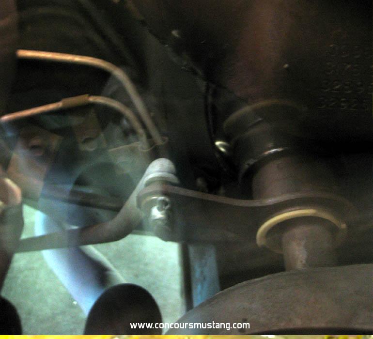

Looks like the outer tube was dark charcoal like the upper outer tube. The inner tube looks to have been  phosphate and oil or at least that look originally.  No weld detail on the lower inner steering shaft on the exterior- more of a press on. All bare steel other than bare steel and oil it appears.
Heads for the brake clamps appear to be phosphate and oil again.   But here are some pictures for you to look at

Your welcome  Picture #2 is the best of them all as far as original finishes and condition. From one of Bob P's low mileage Dearborn 70 Boss 302's
