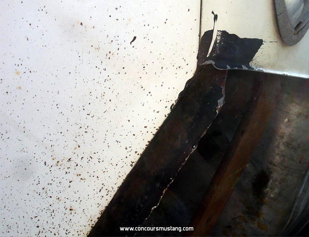

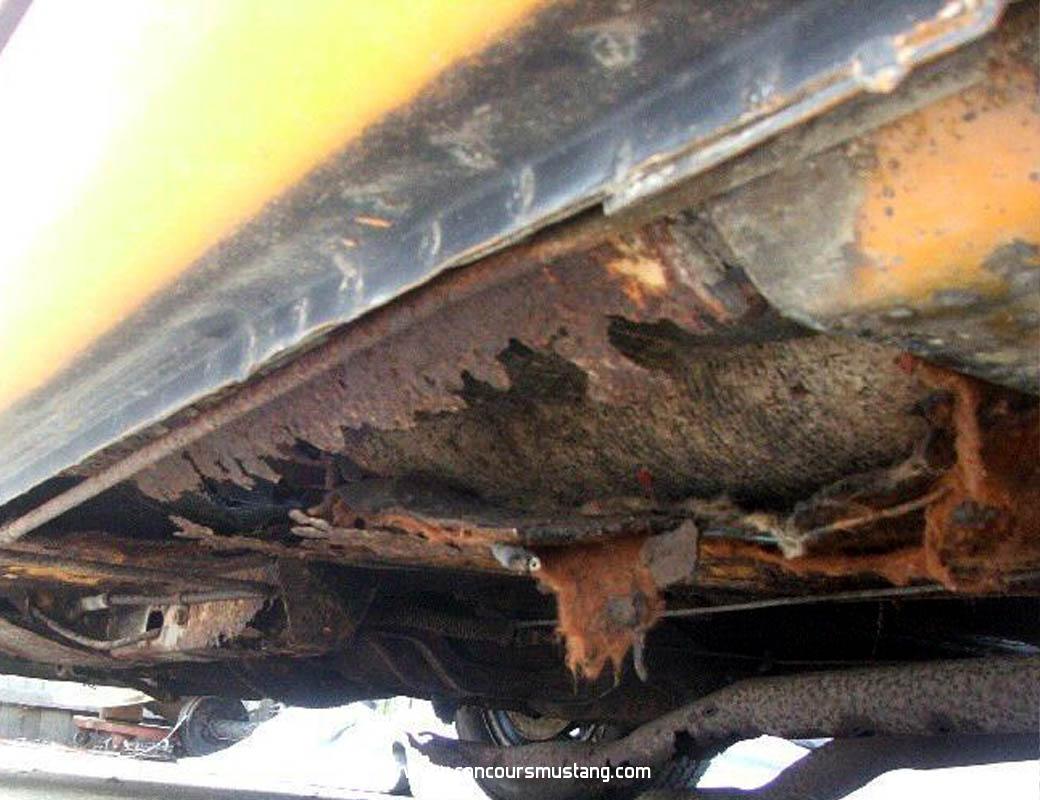

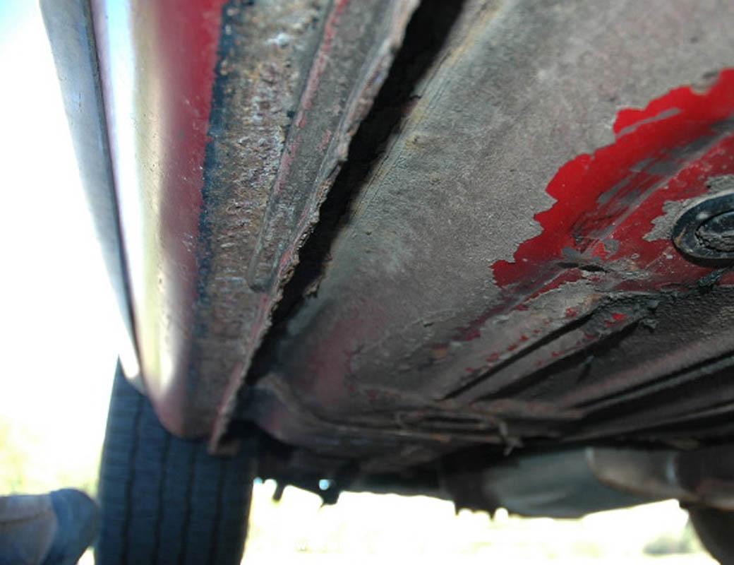

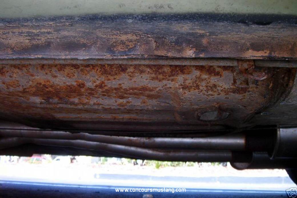

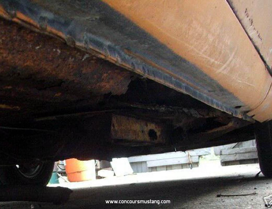

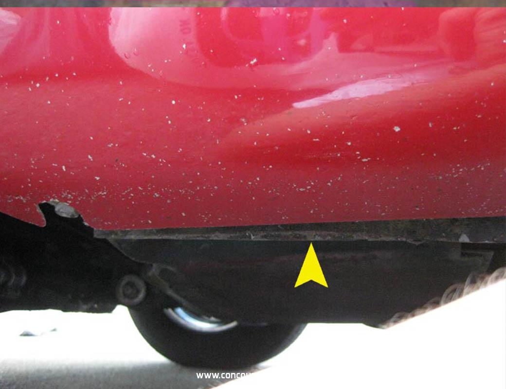

Some supporting pictures (none of the bottom of the door since there is not much to see ;)
Sorry the Dearborn car's undercarriages are in such poor condition or uncleaned so they do not show the amount of overspray and coverage (in these) on the floor and frame parts behind the rocker panels - inward
Hope these help
Spray gun got real close on this one]Spray gun got real close on this one
