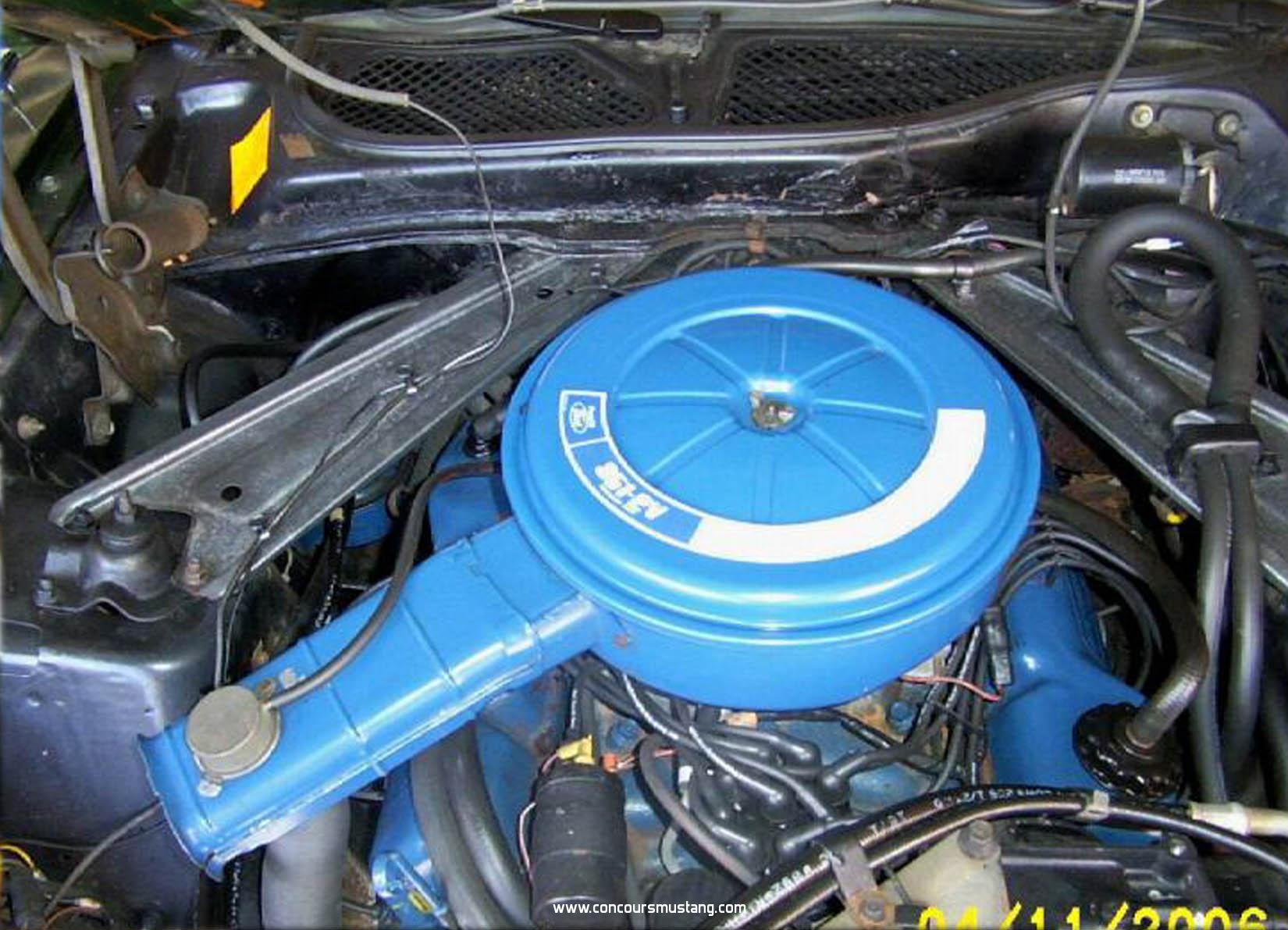

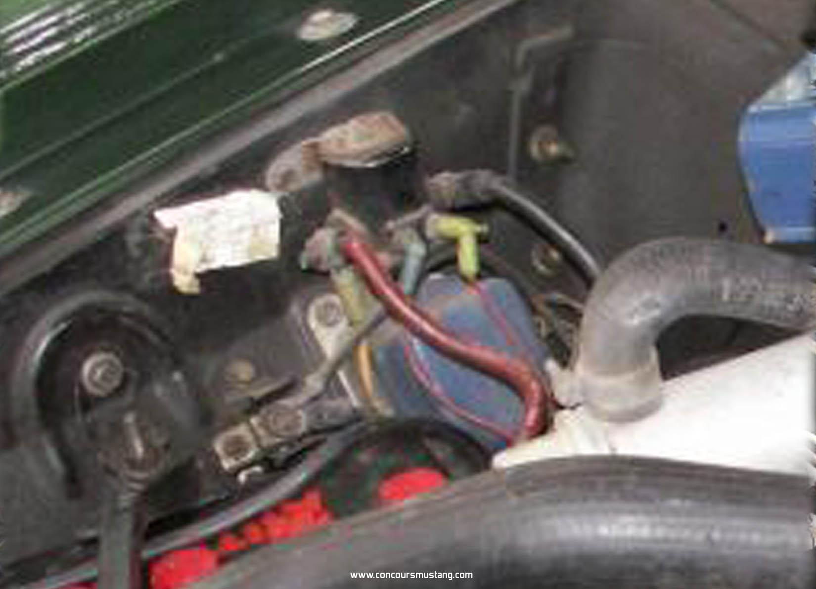

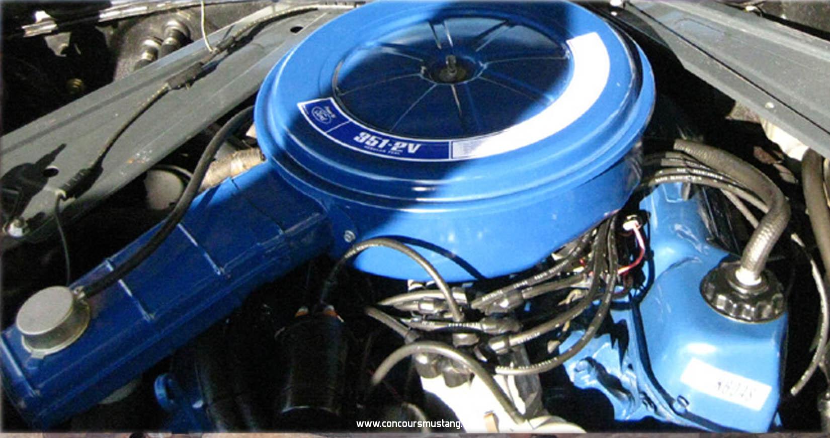

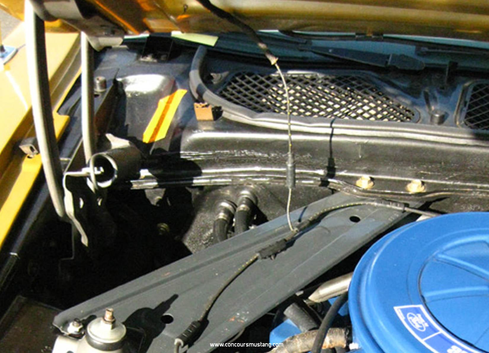

Here are a few original examples - could not find one with a valve cover timing decal on it. First three pictures are of   a very nice original local car. The last from a internet ad - reported to be a 15K mile car. Think the local car was/is much nicer
Bottom one is a very very early car (VIN suggests first few days of production)   and it uses a different colored cowl decal. Likely just another running change

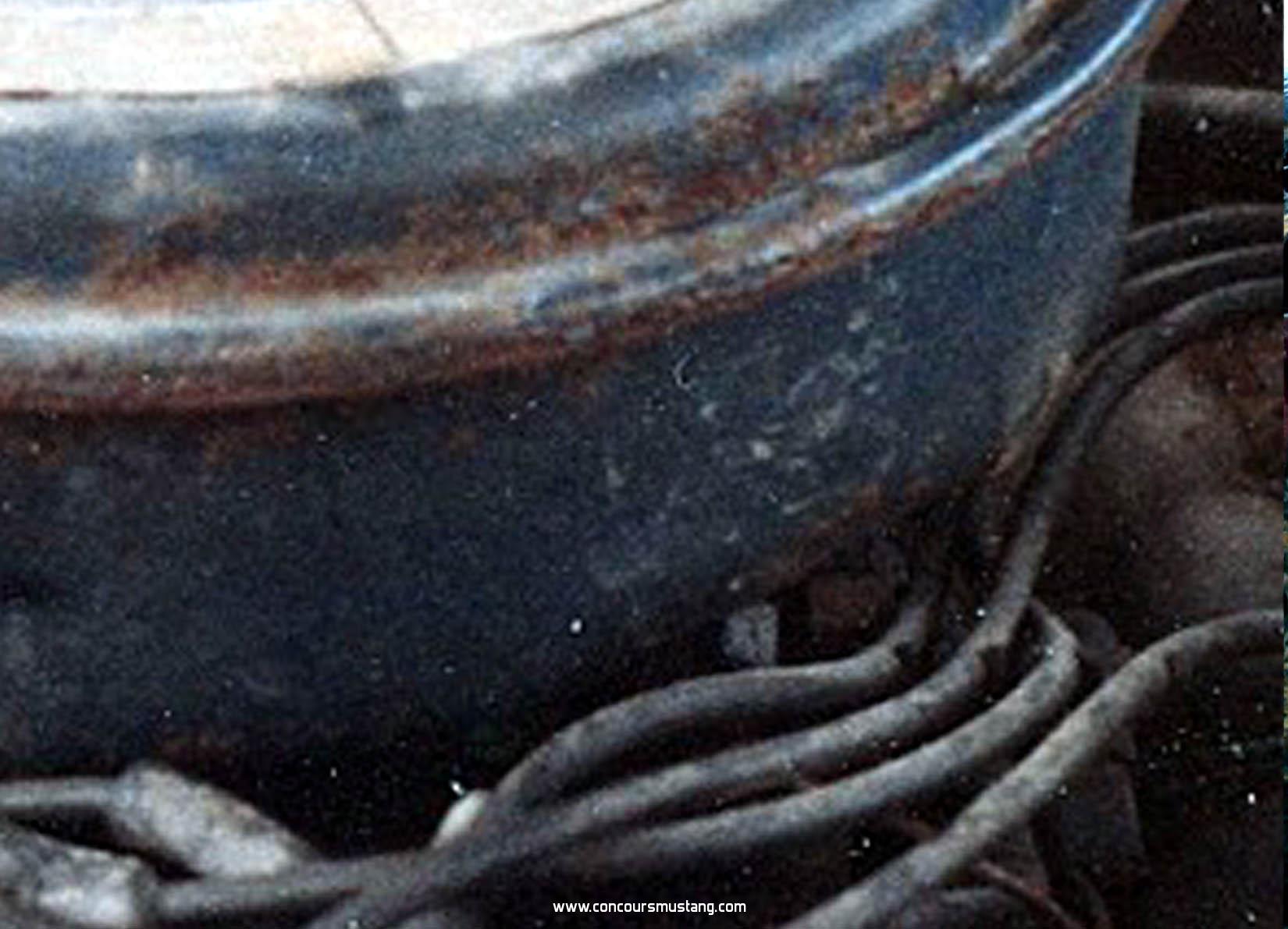

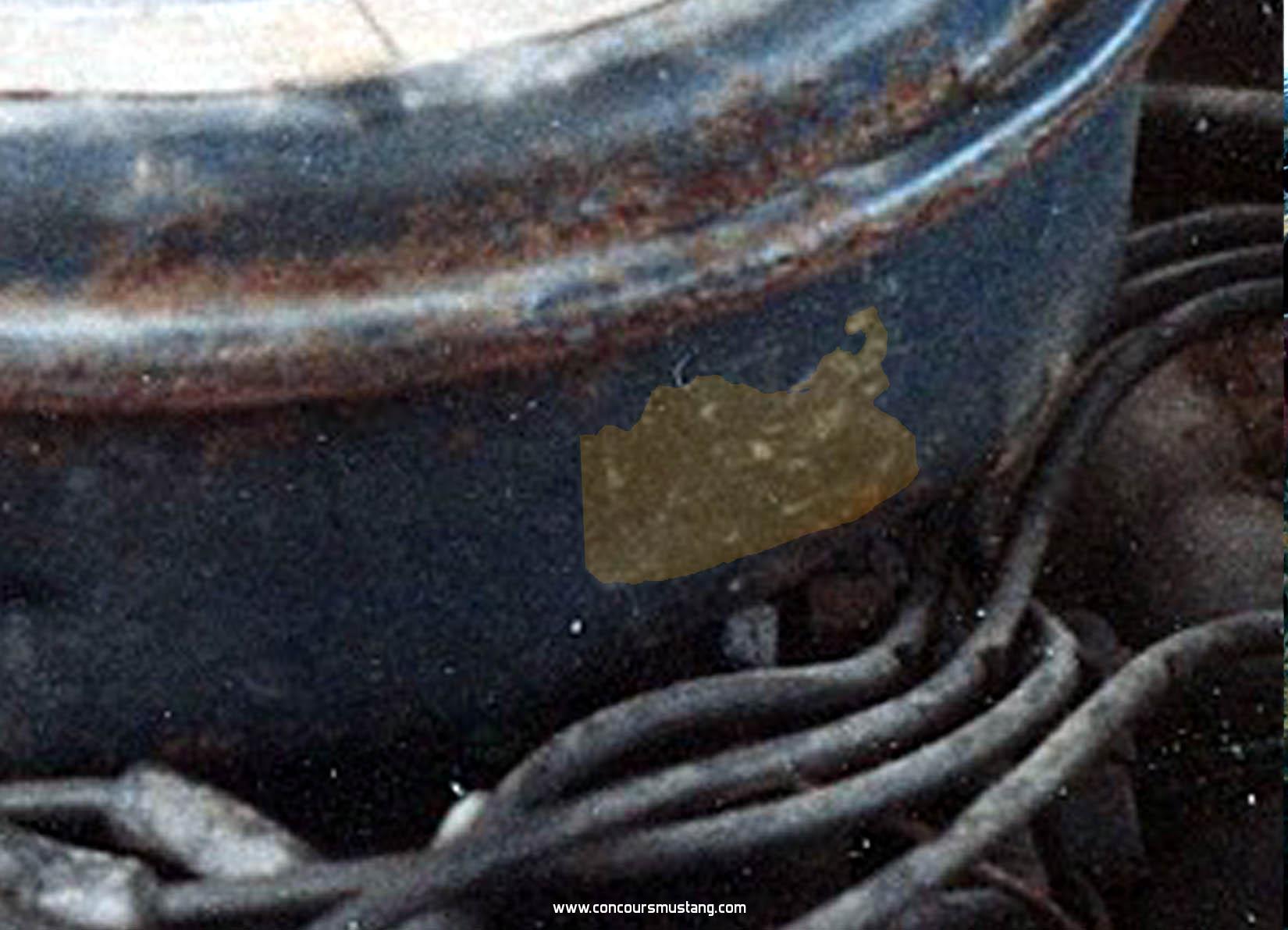

Thanks for the continued feedback.  I went and pulled some of my early 80's pictures of the car.  I apologize for the grainy quality, but it was the 80's.  What would the opinion be on the sticker remnants on the air cleaner housing pictured below.  If you look just above the plug wires there is some residual paper or glue on the housing.  I am not sure if it is the same size as the FRONT sticker or not.  Thoughts/Opinions?
67 GT S-Code, San Jose, 06/67
72 Mach 1, Dearborn, 01/72
Re: 72 emissions 351 2V decals
« Reply #5 on: April 09, 2014, 01:30:23 PM »
Looks like that is much taller and  a bit wider than the FRONT decal
Believe it might be the part number decal that is sometimes found on these taller air cleaners.

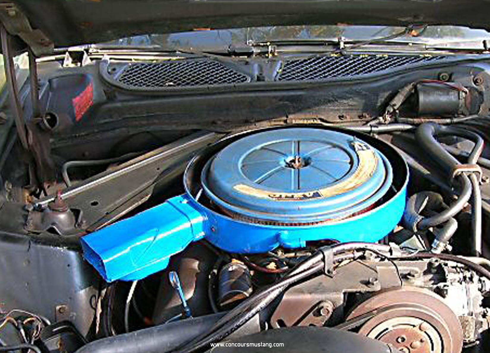

Your picture
Area where there appears to have been adhesive highlighted
Don' t have a picture of them from a 72 example (not as many of those have been saved but do have examples of what remains on a number of 73's with the same style of base
Two different cars shown in the picture - as you might be able to make out - not always placed exactly at the front of each car
At this moment - that is my best guess ;)

The small rectangle sticker on the side of the air cleaner contained the engineering number of the air cleaner housing, which was a 73 only sticker. .        The front sticker wasnt used after 68, because air housings used after that had built in indexing tabs which allowed the housing to go on the carb in only one position.
Offline D1ZX
  • Posts: 18
« Reply #7 on: March 27, 2015, 07:20:43 PM »

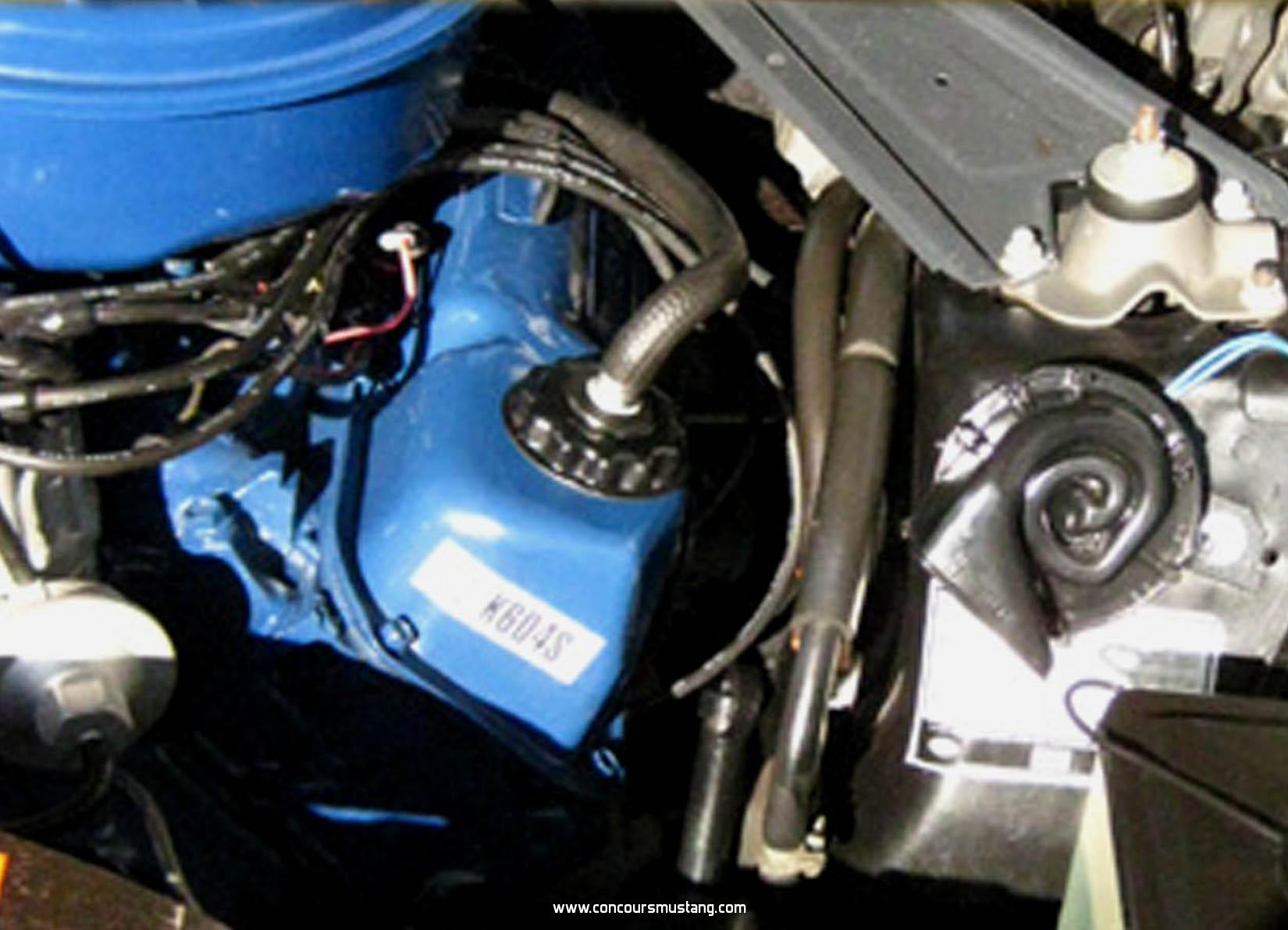

Here's that sticker shown on a 73 housing that contained the eng or service part number only. No 'front' sticker was ever used 71-73........but they sell them to u !
